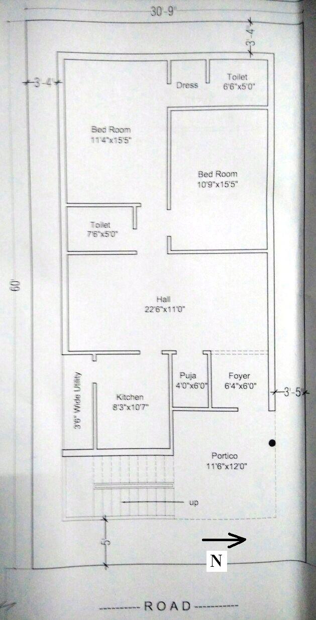

i would like to know i can plan a cantilever beam
of length 9 feet long in the north east portion of my
construction to provide space for additional car parking
i am attaching my floor plan.
thanks and regards
srinivas

Dear Srinivas ji..Kindly mention column sizes, positions and reinforcement in columns,if it is okay , a Cantilever beam can be planned...A long cantilever beam should be avoided, if possible ,provide Columns to support structure,especially in Earthquake Zones.. Regards.

Dear Srinivas
As stated by Sh Navneet Jharia you can plane with column and avoid cantilever. In case if you want cantilever than I am in opinion you should have proper structure design from civil engineer.

Cantilever upto 5 or 6 feet is enough, but 9 feet is too much. You must avoide it in residence. Make an extra column.
