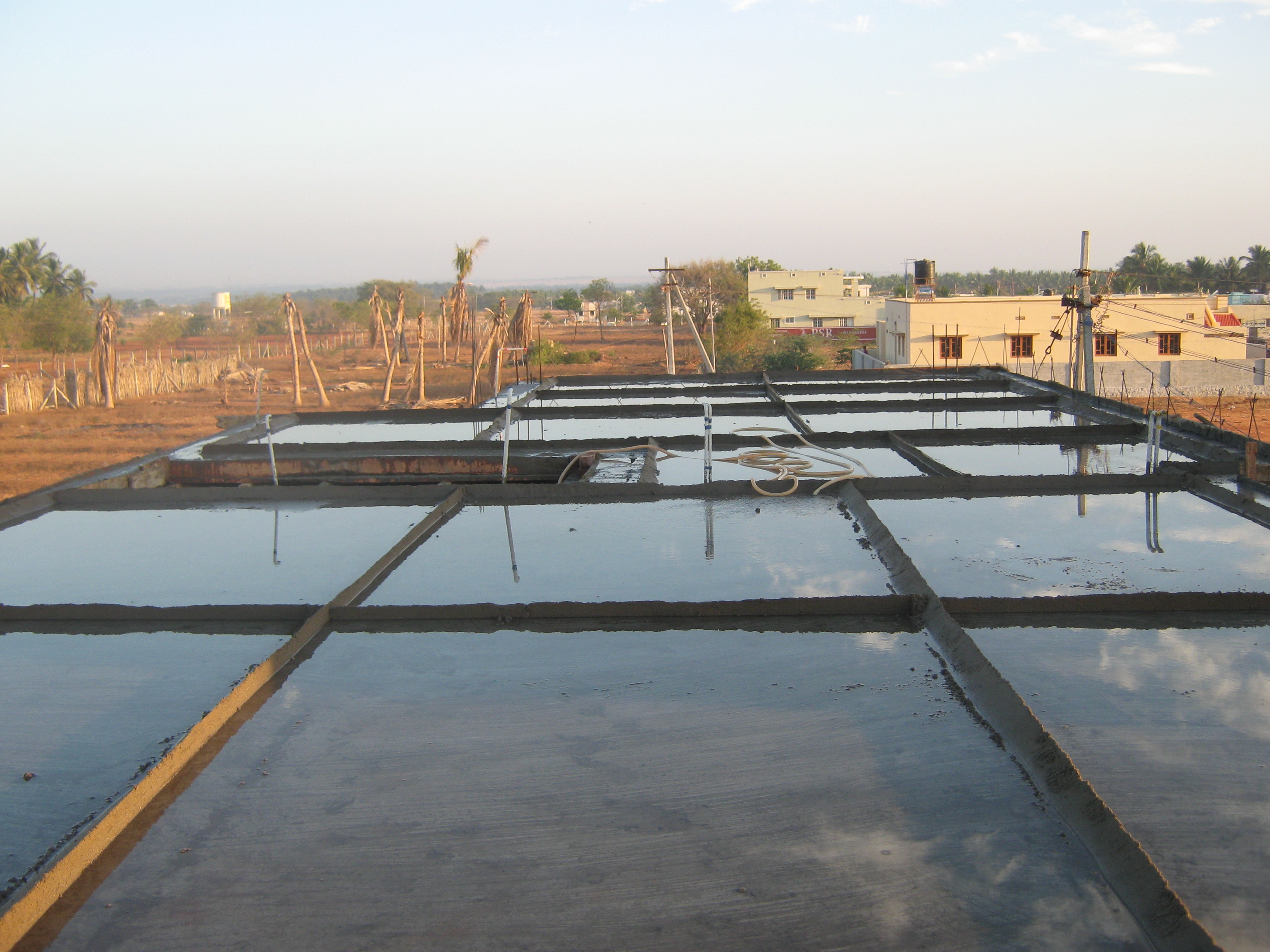

Dear Mr. K Umapathi, It was left for 3 to 4 hrs. without curing ,don't worry sir , its all okay..The presence of water is essential to cause the chemical action which accompanies the setting of concrete.Normally, there is an adequate quantity of water at the time of mixing to cause hardening of concrete,but it is necessary to retain water until the concrete has fully hardened. As you are using 'Ponding', is a very effective method..the depth of water should be 50 mm to prevent evaporation...Regards. | |
Sun Mar 16, 2014 | Post #2 | K Umapathi
Join date: Jun 2013 | Post subject: CURING ON ROOF Slab
Dear Navneet Jharia sir,
Thank you very much for your prompt reply. Your positive answer given me a sigh of relief. Thanks again sir.
With Regards, K Umapathi.
