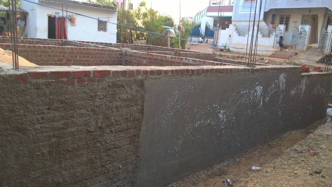

Hi Am constructing a new house, the house basement is 6 feet from ground because the road level is 5 feet than ground level. My Contractor said to construct a compound wall of height 14 feet Height( 3 Feetbase +House Plinth level 6geet + Wall 5 feet). Am scary about this. 14 feet wall? Any Alternative for this? attaching the House basement image.Thanks

Dear Pramod,
           You should construct RCC Column and lay beam on ground/ road level than construct 5' high boundary wall on the beam.
