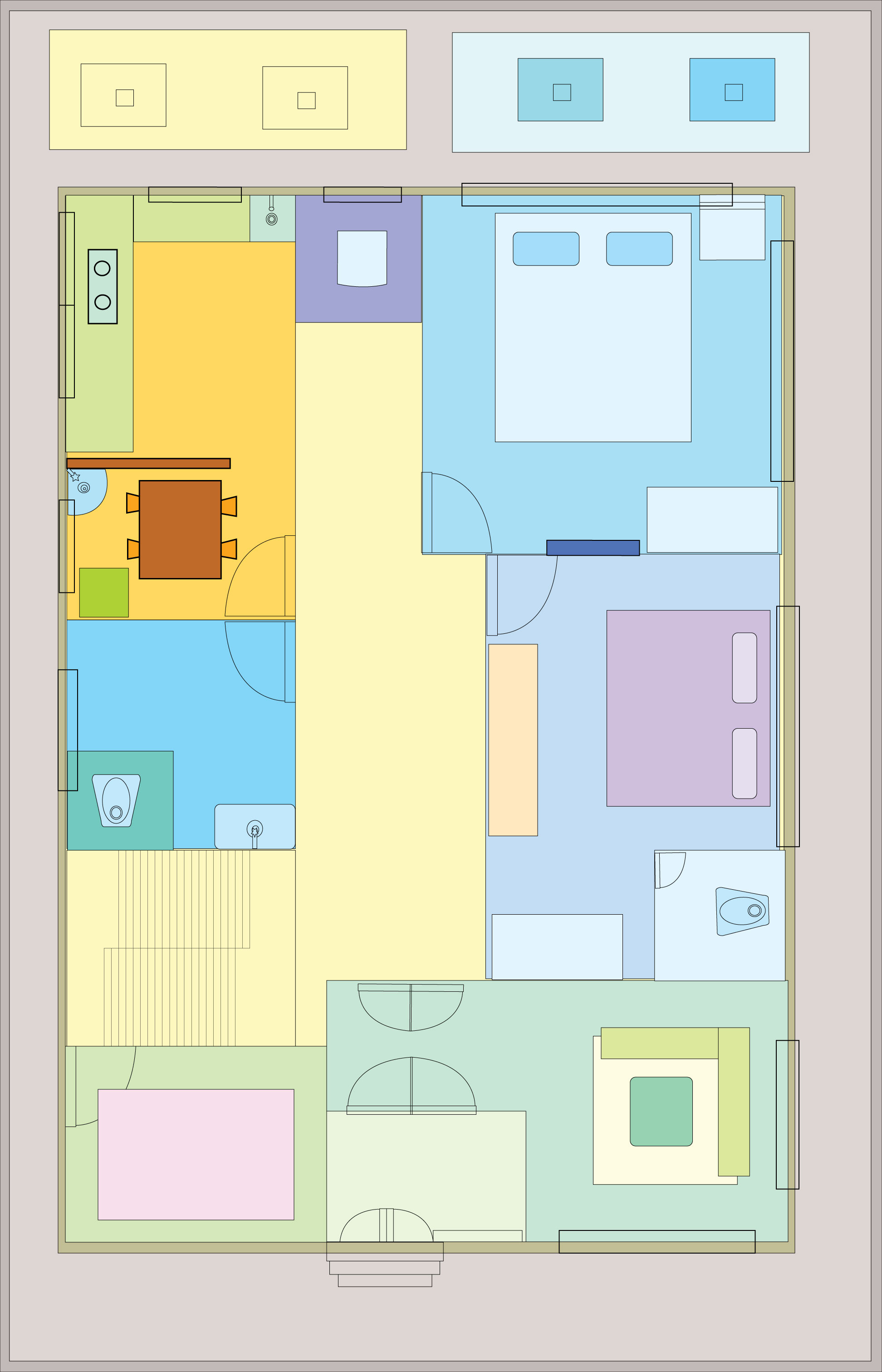

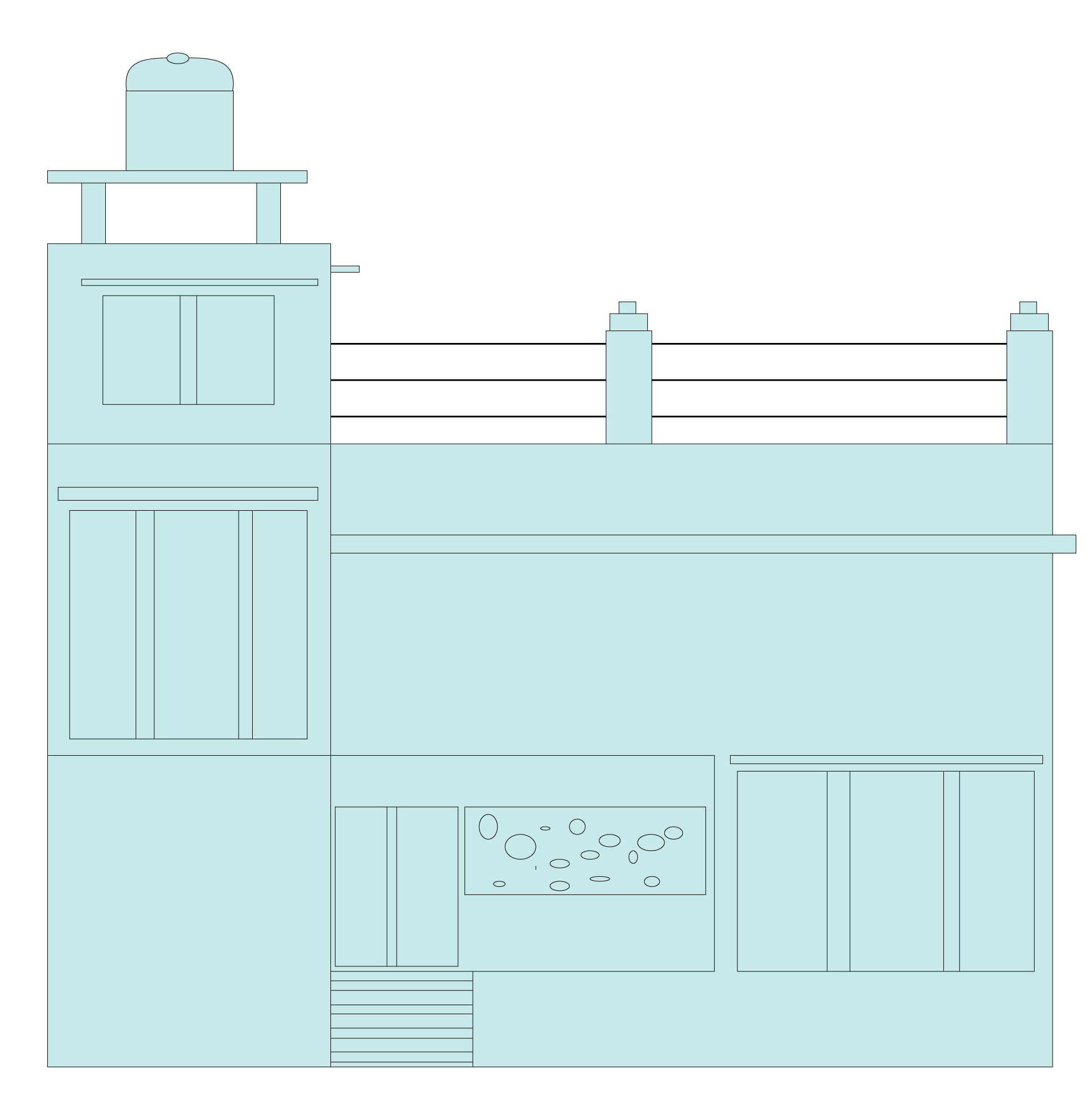

I need a rough over all estimation of construction an individual house. Some factors I am mentioning below should consider at the time of preparing the estimation.
  1. Land: 1kattah 8 chattak. =  1080 sq. ft.
  2. Build up area = 720 sq ft.
  3. 1 master bedroom = 11'.0" X 11'.0"
  4. 1 bedroom = 13 x 9
  5. attached toilet = 4 x4
  6. 1 Kitchen cum dining area = 7 x13
  7. 1 toilet = 7 x 7
  8. 1living room = 7 x 14
  9. 1garage = 8x6
  10. 1 mezzanine room = 8 x 6
  11. Height of the rooms = 11 ft
  12. Height of the house from road level = 5 ft
  13. Doors will be blocked wood
  14. Windows will be glass and aluminum
  15. One Puja room will be at the top of the building.
I want to give this order to a contractor. He will hand over me the key of the finished building. I have attached a rough plan of my house.
Again I need an over all idea not exact or breakup costing. It will be better if anyone one can give me per square feet rate.
Thanks & Regards,
Pritam Karkun
Attachments: Building-Pritam-Karkun.jpg Wed Apr 04, 2012,
floorplan-pritamkarkun.jpg Wed Apr 04, 2012,&n

Yes drawing was made by me. I wish that my home will be like this. Surely my architect now easily can deliver the design where almost no changes or modification required.
