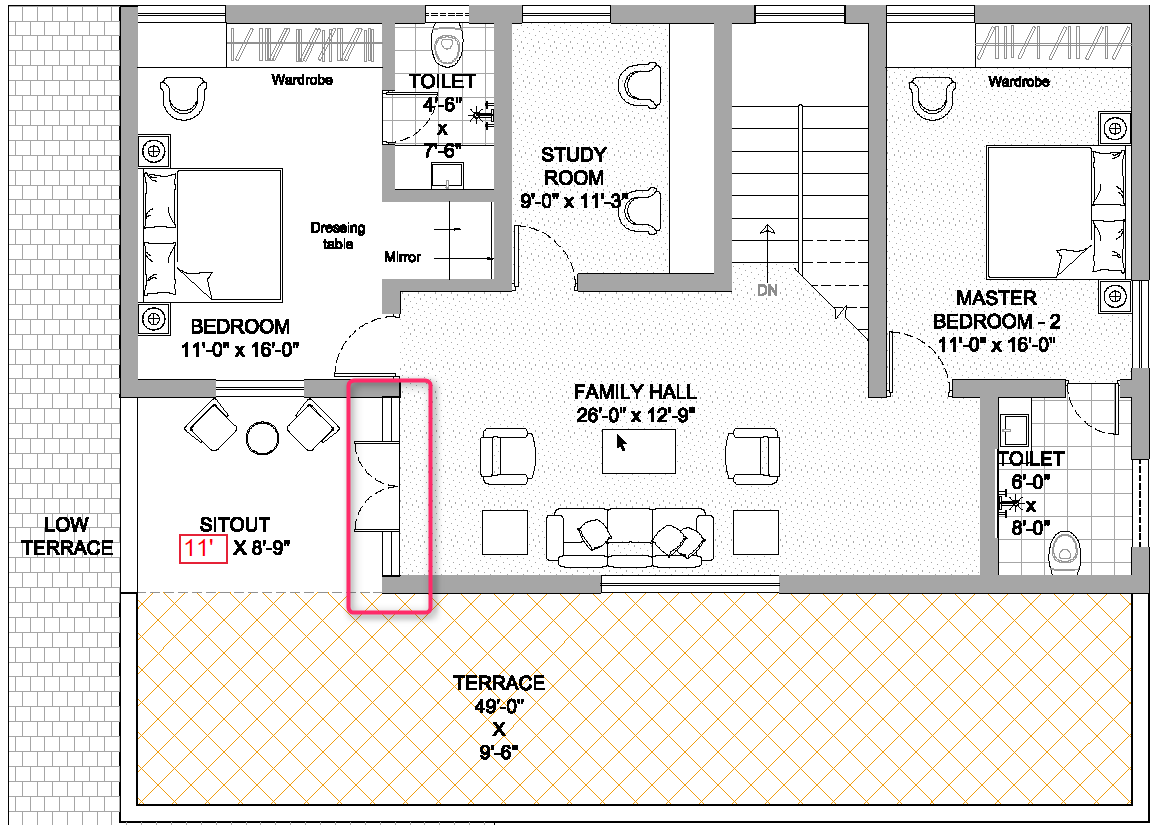

Now I am constructing my home, it is a G+1 building, north facing.
I have staircase inside the home.
Staircase leads to the hall in First floor and two bedrooms on two sides.
There is a door for the sitout.
Please suggest me if I need a wooden door here, also alternate materials for this door.
First floor plan attached here.
Please suggest a place for TV position and sofa position.

Go for full height sliding aluminium/UPVC window,they are better for openings exposed to environment in comparison to wooden doors and are light weight too.
You will enjoy full view from the family hall to sit out and vice versa,
A double glass unit will give you sound insulation and a mosquito net provision can also be made (good ventilation and no mosquito)
hope this helps
