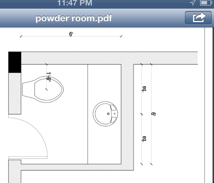

Dear sir, thank you for your assistance on this subject. I have attached the drawings of the bathroom along with the details of the above counter basin. I have already bought a wooden ply type sheet around half inch thick to be used under the counter. I hope this information will suffice but if you still have any questions please contact me immediately. I hope that the attached files are clear. Thanks

Thu Sep 05, 2013Post  #5
GUNA
GUNA
Join date: Feb 2012
Hi Gautam.
Fabricate L angle (2"x 8 mm) frame of size 1'9" x 6'0" with 2 inter support(6'0" side)
Fix the frame on the wall with required anchor fastener on all three sides having
frame flat surface on top
Fix water proof ply on the frame then put marble
Fix marble skirting (back splash ) of 6" ht,on all three sides
Fix 9" ht 19mm water proof ply with laminate finish below the counter vertically
on the front side of the counter (6'0"), this will cover the bottle trap of basin
I hope this will solve your issue
