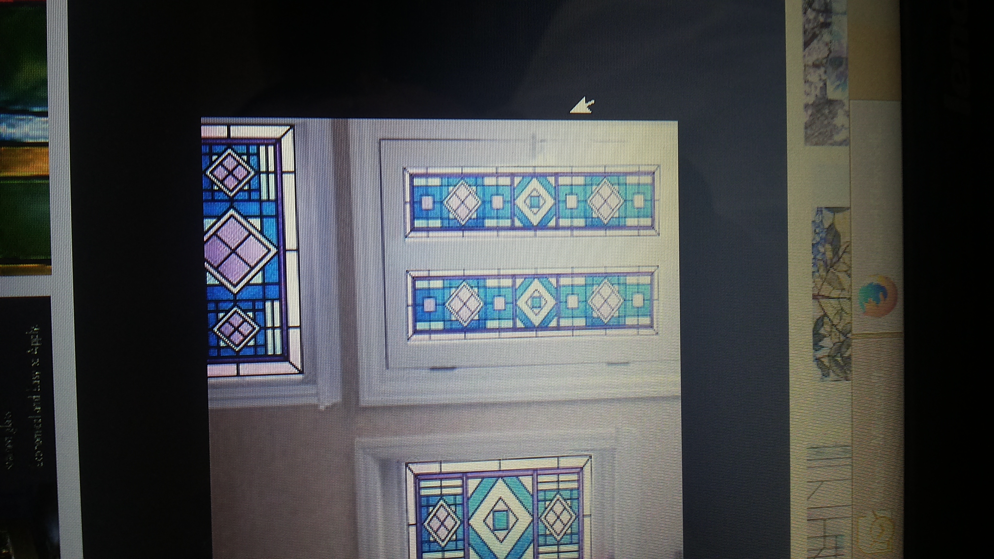

Anyone have used 2 types of doors i have attached
What will be there exact names 1. Stain Glass Doors 2. Membrane Doors (but local carpenter dont understand membrade, or is it carved doors)

Stain Glass Doors are having wooden frames outside and glass in the middle, can be made or bought readymade. Membrane doors are readymade fkush doors with pvc sheets on surface both sides.
