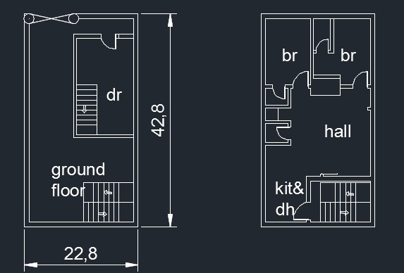

I am building a three storey house and i want to know how to design .placing of columns and designing of columns and beams for 100 yards rectangular plot. plan view is given and facing of plot is north. it contains 2 bedrooms ,hall,kitchen in 1st ,2,3 floors and and attached toilets. and drawing room for 1st floor is in ground floor it contains interior stairs. plz show the column placing and slab,column,beam design,. | | | |

In my view it is better if you take proper design from any structural engineer, because the situation of columns are according to the detailed plan of the building/ house, according to the loading position etc. However in hit and trial method you may place 6 nos columns. | |

Join date: Jan 2013 | thanks for advice sir, sir plz can u give the column design and which place column should be placed for the above plan.
