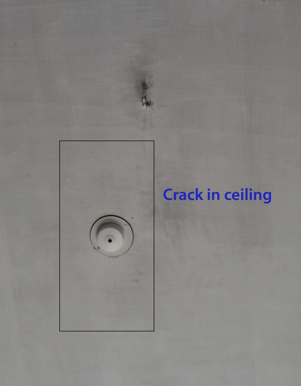

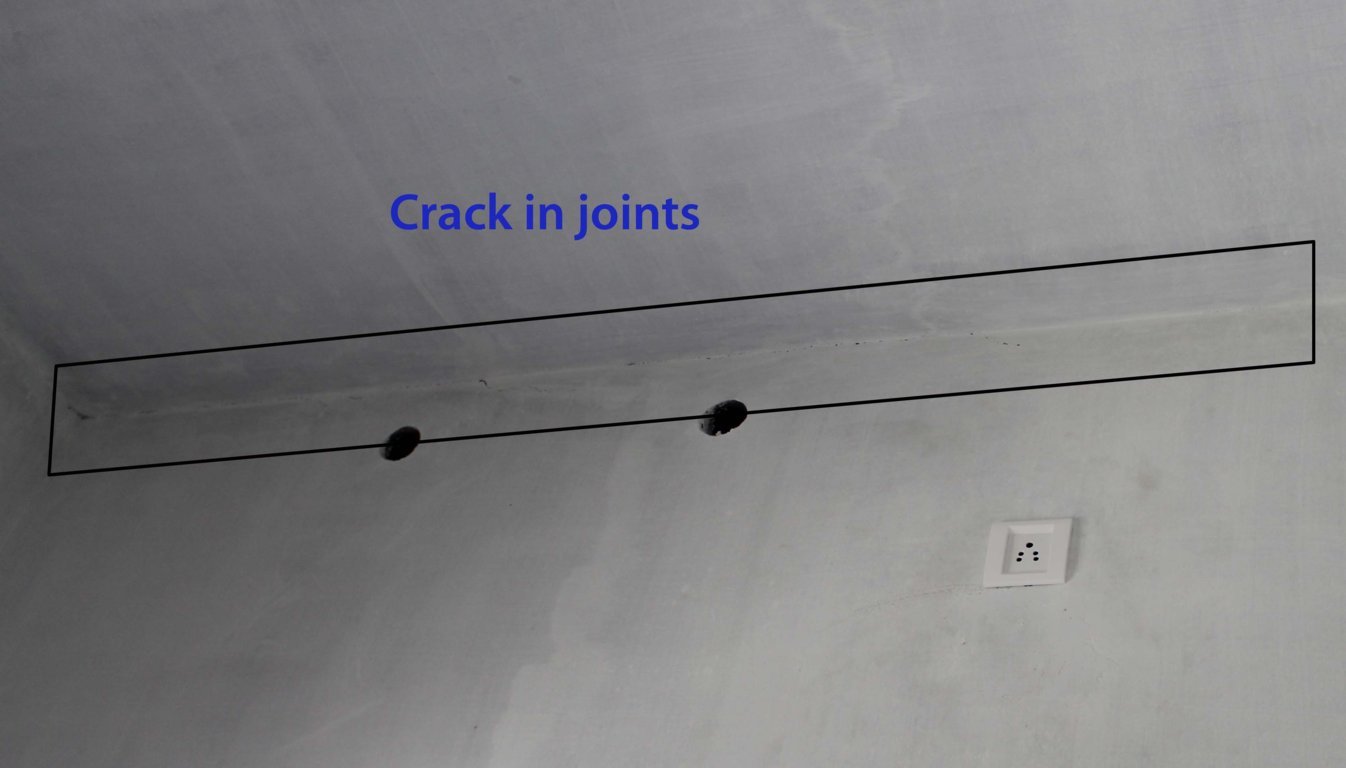

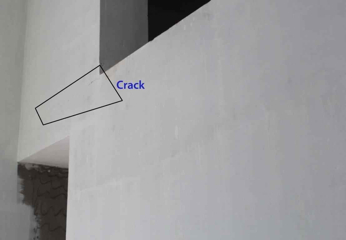

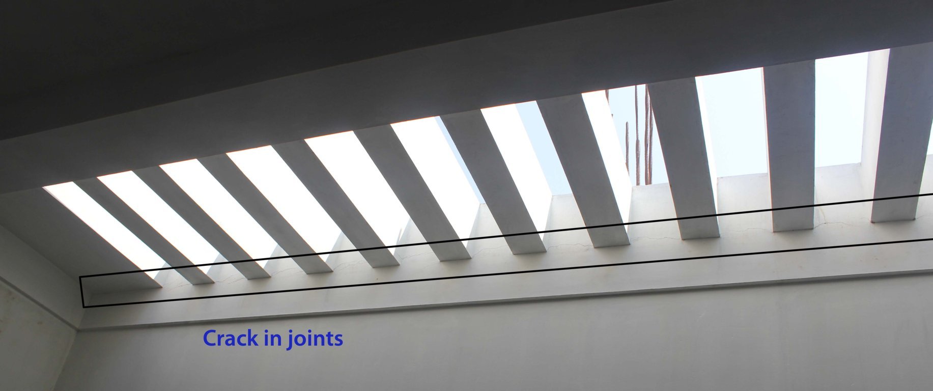

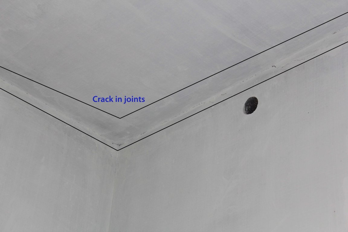

I need some suggestions form experts to remove cracks , the electrical work is still going in house during that time we notice so many cracks in house like joints , ceiling etc . I attached those images

When I asked the contractor he told that it was happend because of electric pipe through roof.  bt when i asked about the cracks at joints he has no answer

Dear Viju: For cracks in joints and other places, chip off the old cracked plaster, install chiken mesh and re-plaster properly.
I hope it helps.
