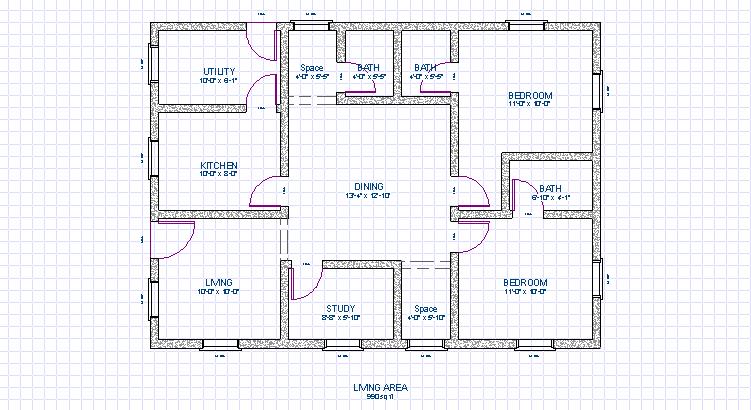

Please see my proposed house plan and suggest if any modifications needed.
Attachments: Plan_1.2.jpg on Sun Apr 01, 2012,&n

         I like the fact that every room on the perimeter has provisions for cross ventilation. The dining room has been located in the centre with no provision for fresh air intake or daylighting. This will increase you operation cost. I suggest you incorporate high ceiling with a roof vent or solar chimney above the dining room. This will ensure optimum day light and ventilation through the stack effect.
Hope this helps.

                I don't found any stairs & seprate entrance  to lobby. keep this in mind.
