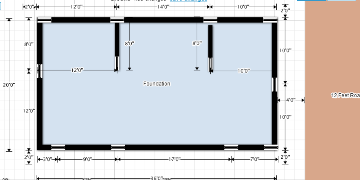

Firstly very informative website and great work with the articles.
I have made the design of my house myself with some consultation and the help of this website. Initially I had planned to build only one floor however now I m planning to build the second floor too. The ground floor and the first floor is complete now but I m a little worried if I should build the second floor or not.
Please have a look the layout design
here
The size of all the pillars we have used is 6' x 18'
The bars used is 12mm.
The thickness of the floor slab is 4.5'
Please advice if its okay to build the second floor or if there is anything else I need to do , I would really appretiate your help
Thanks.
foundation..jpg on Sun Apr 20, 2014,&n
Mon Apr 21, 2014
Dear Sayed
I think column size is 6''x 18''. It is better if you consult any structural engineer / civil engineer form your city , who will guide you after inspecting the site.
In my opinion columns as stated by you are weak.
