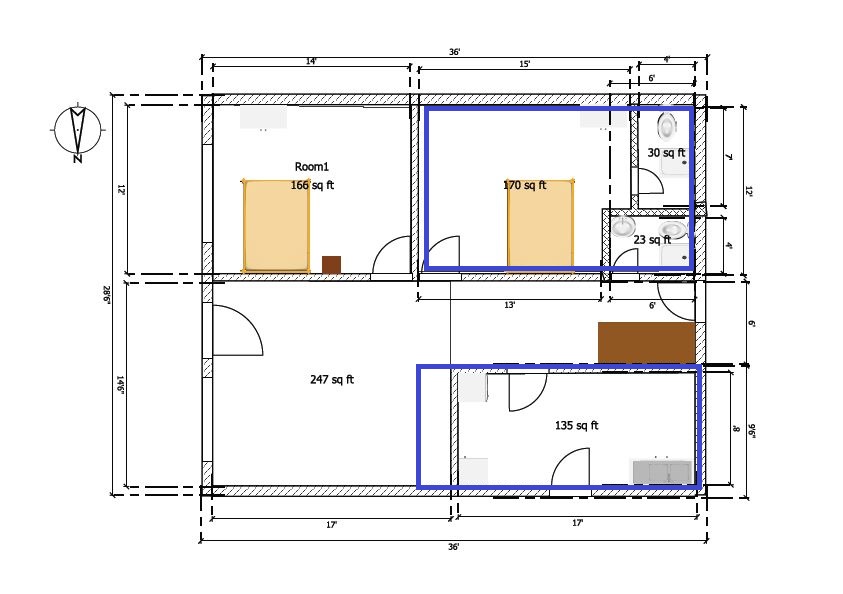

Tue Nov 25, 2014 | Post #1 | richlyn
Join date: Aug 2014 | The proposed rooms are on both sides of the Stair case marked in blue in the attached.

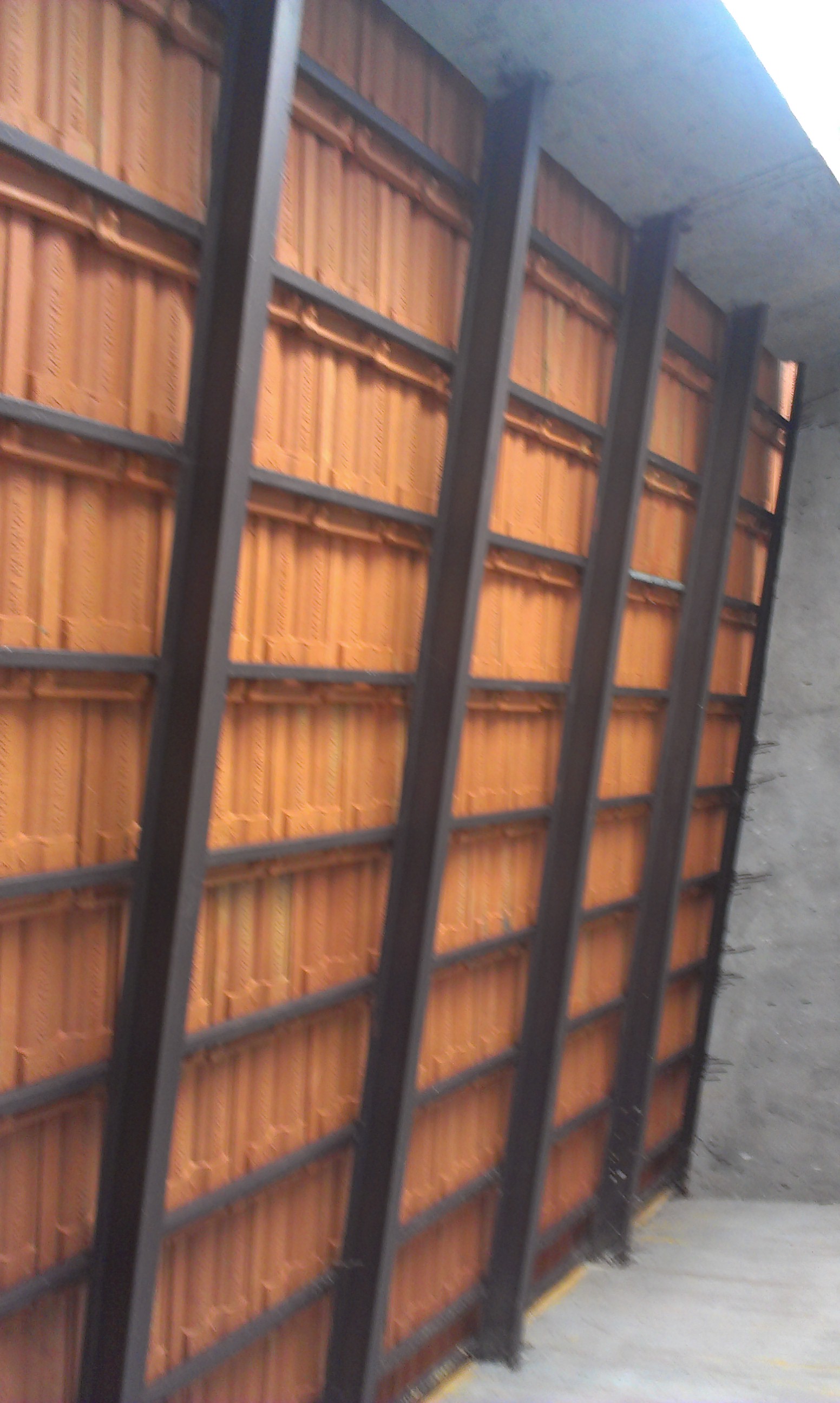

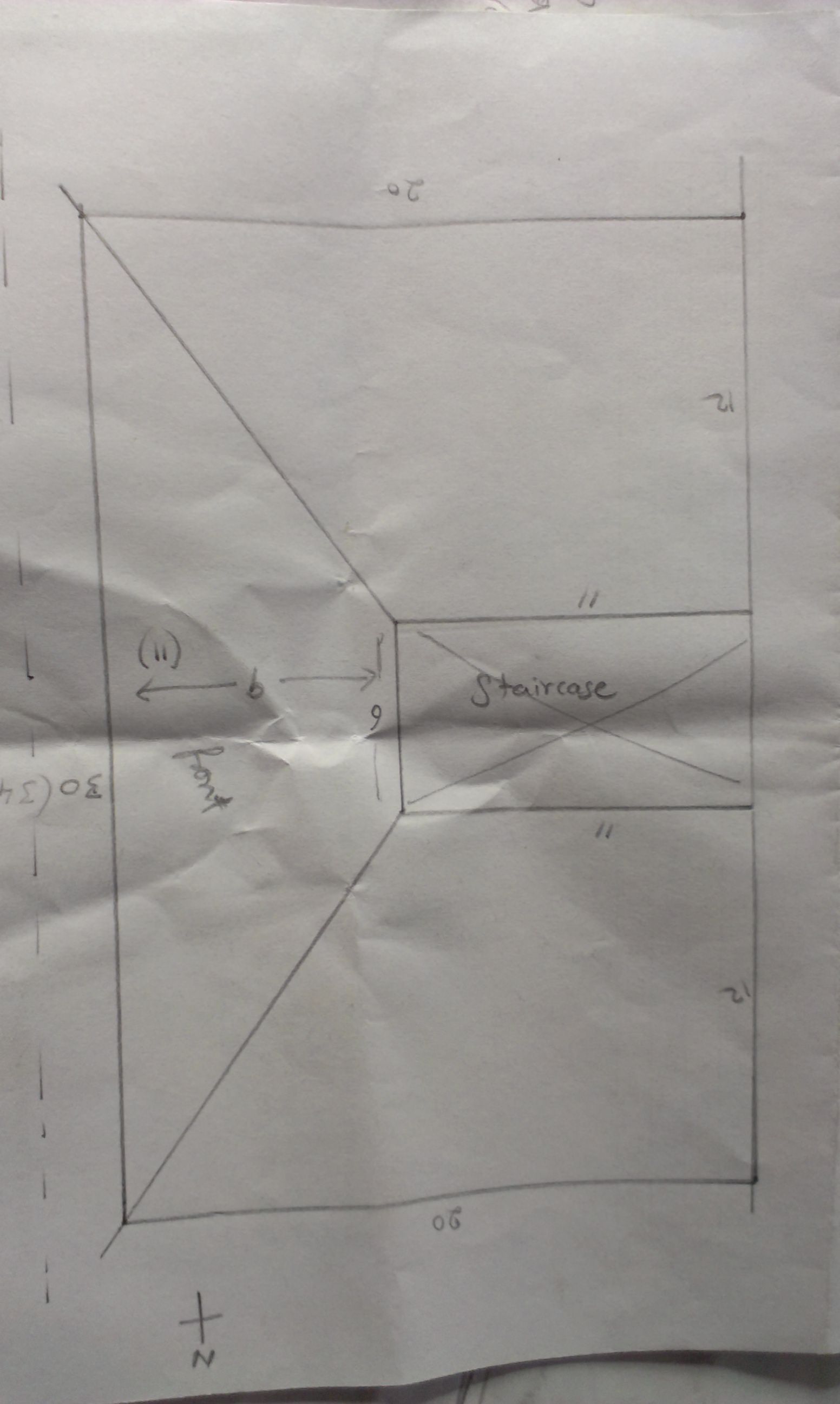

Mon Dec 01, 2014 | Post #3 | richlyn
Join date: Aug 2014 | Thanks S L Gupta.
I have opted for making roof of fabricated steel frames and magalore tied roof. However the fabricator is saying that there are galvanized sheets that look like tiles. this will cut costs and still keep the look of the roof nice.
But i am not sure of this. Can someone help me with the pro and cons of magalore tiles Vs galvanized sheets. Attached is the roof design and a sample tiled roof fabricated structure.
