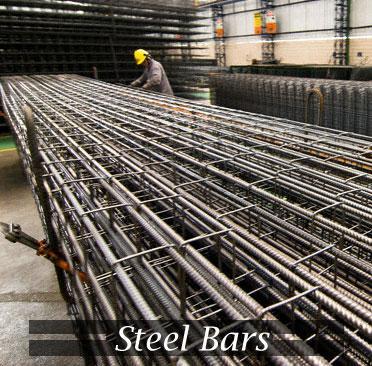

Steel bars used for construction work

Steel Bars for RCC Work
All finished steel bars for reinforced work should be neatly rolled to the dimension and weights as specified. They should be sound, free from cracks, surface flaws, laminations, rough, jagged and imperfect edges and other defects. It should be finished in a work manlike manner.
