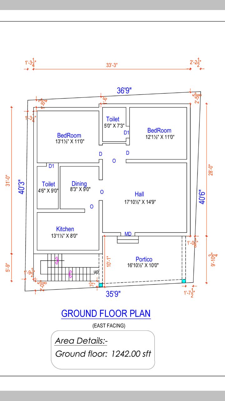

I enclosed my house plan.. my house is two bedroom set. i wanted to make wardrobe in the bedroom..
Size 1 bedroom : 11 feet Width x 11 feet Height x 1.5 feet Depth
     5 Shutters (2'+2' +3' +2' +2') centre with Dressing glass
Size 2 bedroom :  12 feet Width x 11 feet Height x 1.5 feet Depth
     5 Shutters (2'+2' +4' +2' +2') centre with Dressing glass
My Contractor says both will have a cost of Rs.2,50,000 approximately.

Dear Prabhu,
          First of all you should clear the procedure of measurement of warde robe when give on the labor rate, later on it will take dispute.
Take IS marked water proof mdf board.
Before using the board and other wooden items, treat them with anti termite solution.
