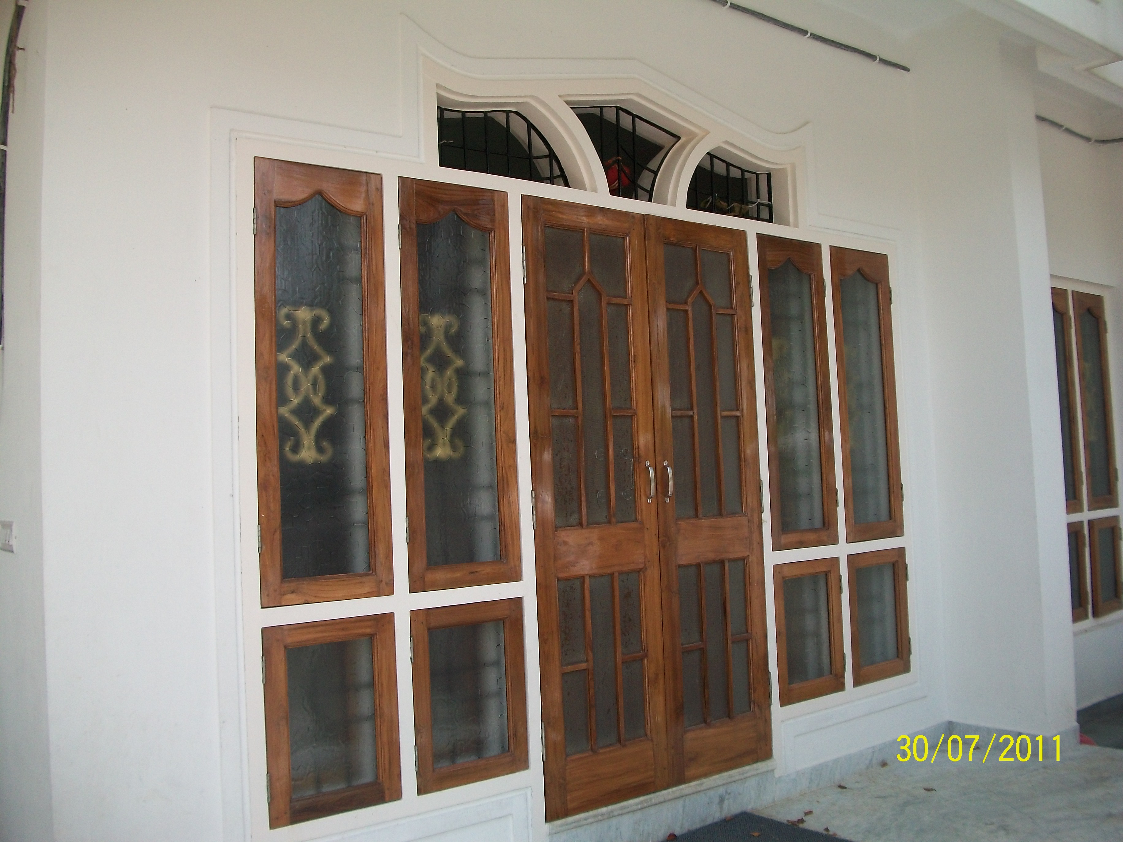

Dear Mr.Arvind Goyal , Hello..! Dending you a photo of Composite Door ( 10' x 8'-6")for entrance ,kindly go through it, its section is 11" x 3", with MS grills, Glazed and Mosquito net door shutters, for other outside doors a section 6" x 2.5", for other internal doors section 5" x 2.5" is enough. Sizes of doors- 3'-6" x 7', 3'-3"x7', & 3' x7', for toilets 2'-6" x 7'.are standard sizes. | | | |
Thu Mar 19, 2015 | Post #2 | JAI PRAKASH
Join date: May 2014 | 6x2.5 for outer doors. (Double Doors) 5x2.5 for inner doors. (Single Doors. 4x2.5 for Toilet and washrooms. | |
