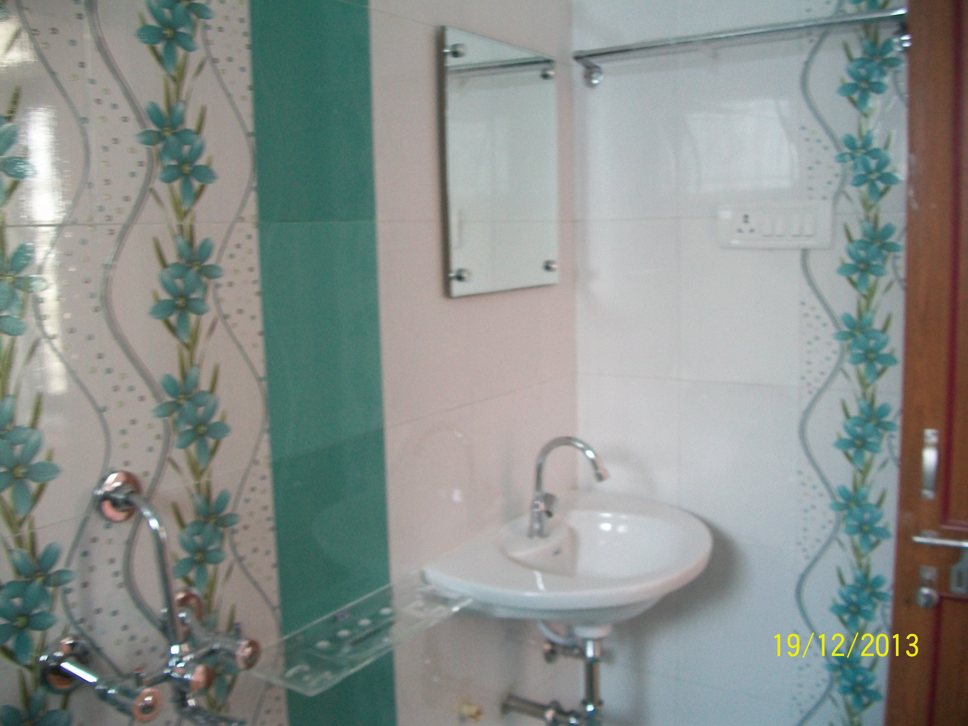

What is acid wash and when is it used. How to remove extra cement from between floor tiles

Hello..! Mam. the acid wash is used on glazed wall or floor tiles,especially to remove spots and sticky cement mortar during construction, it loosen the extra cement mortar ,which is removed by wire brush.from the joints of tiles .The coloured joint filler is used to refill joints to give final finish.....regards.
100_4288.JPG Sun Mar 23, 2014,&n

If your home construction is going on. then tell the contractor to clean it at the time of tile fixing. once it is set and become hard, then it will be impossible to remove extra cement between joint.
