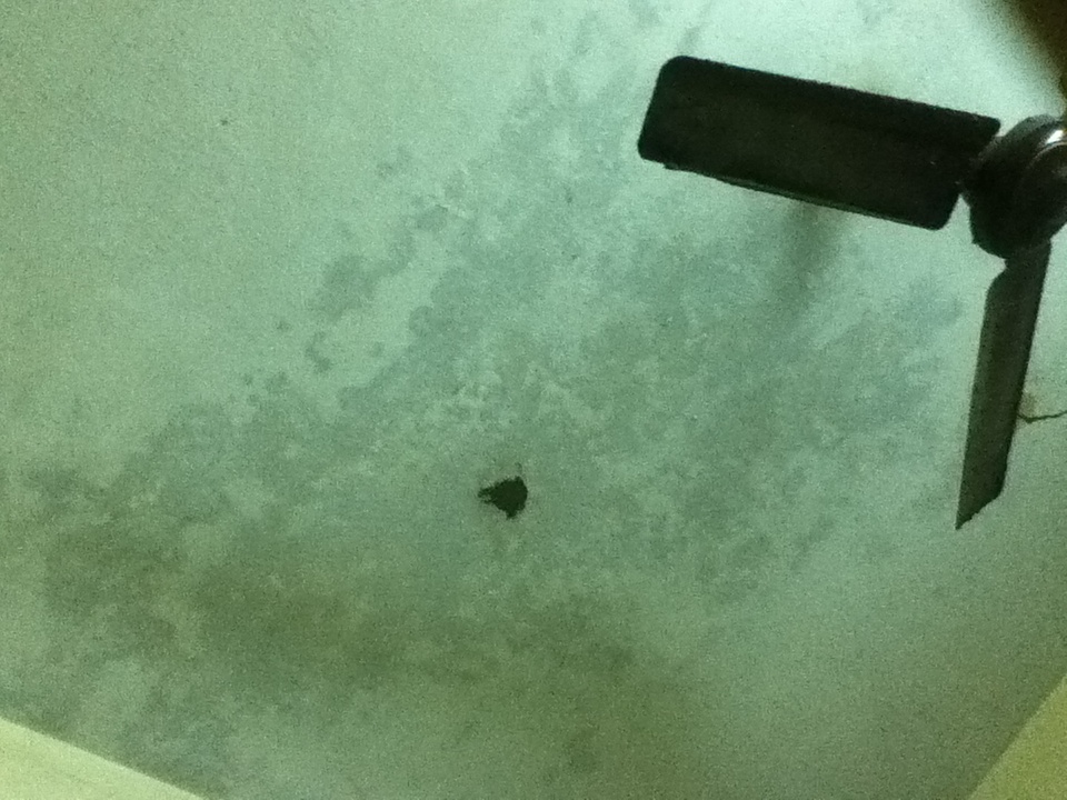

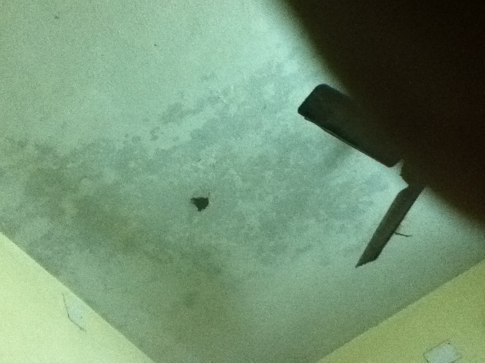

             I have 4 bathroom on first floor and i have seen some dampness on groundfloor. but it was for the past 5 years. no water falling down. i have 4 bathroom in first floor . one indian and one western each house. seen this at GF below every bath room. last year ,i hire mason and converted all bathroom in western by removing upto concrete level and relay the tiles. still no improvement. i have not used any chemical for that time. what to do? where the water come from? any leakage from concealed water pipe in shower,heater area? or water from tile going down? what chemical i have to use now? kindly advice
 in photos, mason tried to chip little to check any water but nothing there so again plaster it
REg
Sunder.M
Attachments: IMG_3231.jpg on Sun Dec 22, 2013,
IMG_3232.jpg on Sun Dec 22, 2013,
IMG_3233.jpg on Sun Dec 22, 2013,
IMG_3234.jpg on Sun Dec 22, 2013,&n

Dear Sunder
        There are many possibility for leakage such as
i. Joint in the floor tiles.
ii Joint at meeting point of floor and walls.
iii.  Joint with floor trap and toilet sheets
iv Leakage in the pipe line and sewer line..
It is advisable to take help from any good plumber who can do after site inspection.
