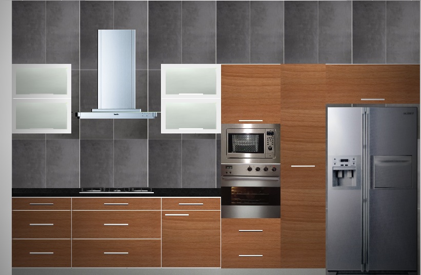

what is the height of kitchen counter top. what is the height of bottom of overhead cabinet from counter top
Sat May 26, 2012Post  #1
The height of kitchen counter should be from 2'-9'' to 3' and over head cabinet should start from 4'-6''.

well the kitchen cabinets are made in mm so precisely the height of counter top should be 820mm to 860 mm.
Attachments: view of wall with appliance unit & cooking.jpg Sun Jun 03, 2012,&n
