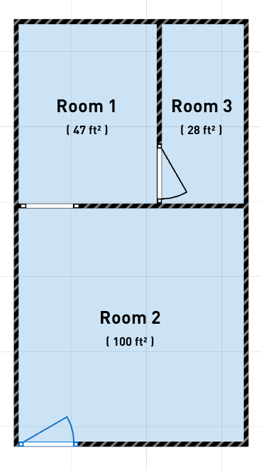

Post subject: rcc and slab work of 180sqft area for 3 floors
Hi All,
I want to construct 180 sq ft area(1RK) for 3 floors.
I want to construct RCC and Slab only. I will pay labour rate to contracter and will bring material by self. I want to know what is a  labour rate per sq ft for RCC and slab work in Pune.
How to calculate rcc and slab area for 3 floors including foundation, 1st floor, 2nd floor and 3rd floor, So I can easily calculate labour rate e.g. 3FloorsFoundationRCCandSlab area X labour rate.
How much material I will need to construct 3 floors(RCC and Slab only). Please find the attached file.
Please help me on this..

Tue Oct 27, 2015Post  #8
Slab is also a RCC work.  Are u saying RCC and wall work?
Tue Oct 27, 2015Post  #9
Baba Dedge
Baba Dedge
Join date: Oct 2015
Hi Sir, Thank you for your reply.
Sorry I was confused between rcc and slab....I want to construct rcc only.
I want to construct RCC for 3 floors and after few months I want to construct walls, plastering etc.. from contracter....
Tue Oct 27, 2015Post  #10
ok.
