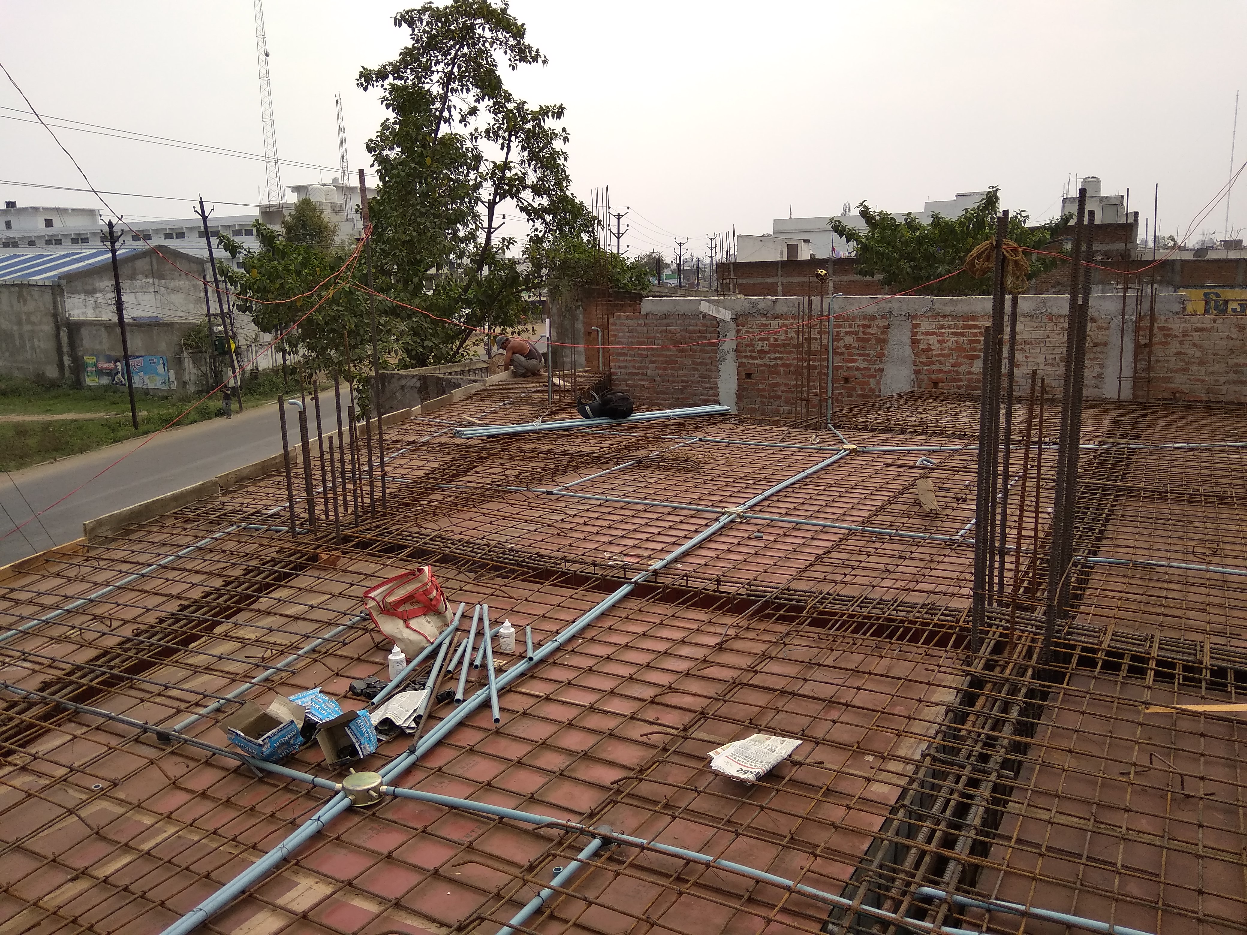

Mon Jul 23, 2018 | Post #1 | Navneet Jharia
Join date: Dec 2010 | Hello.. ! Mani Kumar ji, The quantity of steel required for a slab depends upon its span , that is the distance between walls/beams on which it is supported. So a floor plan of house/construction is very much necessary to get a right quantity of steel required. Kindly send me a floor plan with clear location & sizes of the columns, Approximately the quantity of Materials required are :- Steel - 2300 kg. (Various sizes), Sand - 500cft., Aggregate- 700 cft. Cement 140 bags, Regards. | | | |
Mon Jul 23, 2018 | Post #2 | S L Gupta (Civil Engg)
Join date: Mar 2008 | Dear Sir, Quantity of steel and other materials depends on the house plan and nos of beam provided in it. How ever for roof slab 1800 kg MS Steel is required and this should be 10 mm & 12 mm dgia steel road. For slab only cement required is 114 bags, bazri 570 cft and coarse sand 280 cft. without beam and column. | |
