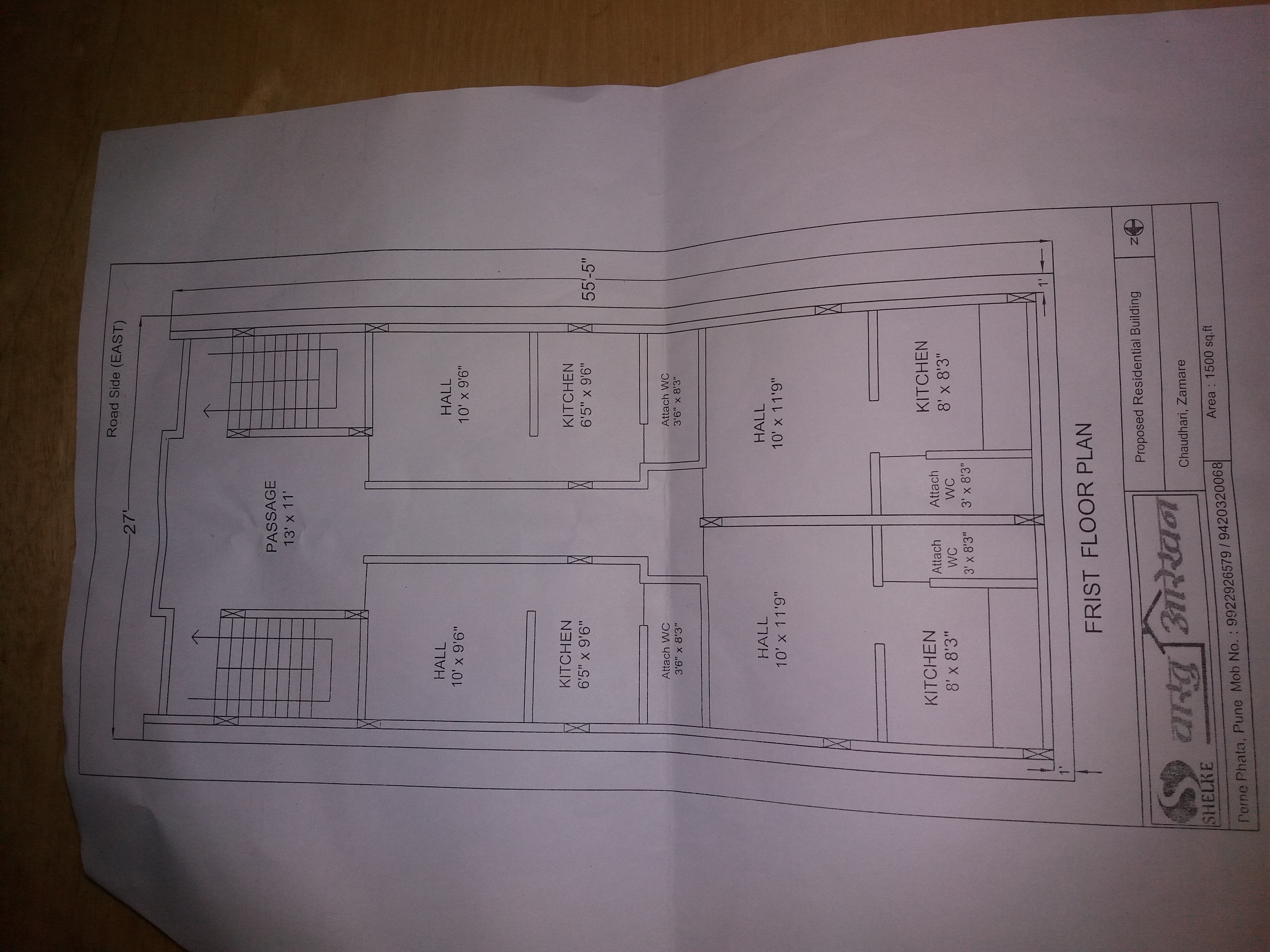

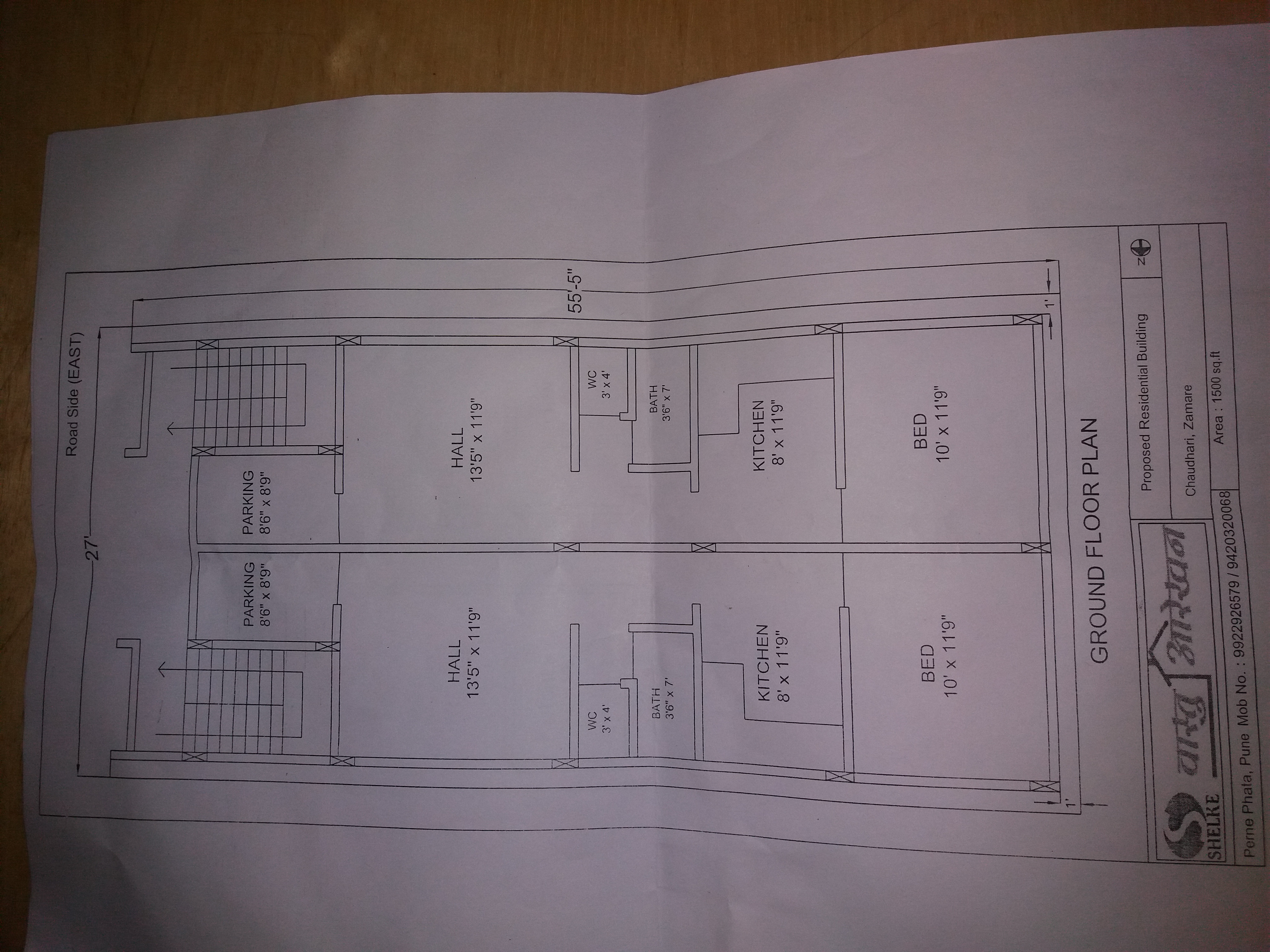

Dear  All,
I want to start my house construction .
we decide column size 6" X 18"
is it ok....
Pl find the attached plan...me & my partner decide middle common wall.
Pl suggest exterior design also
Attachments: Ground Floor SPZ.jpg on Thu Oct 01, 2015,
first floor SPZ.jpg on Thu Oct 01, 2015,&n
Sat Oct 03, 2015Post  #1
Dear Sandy
        If you have wall 9'' thick than take the thickness of column 9'' otherwise 6''x18'' column is right or OK.For exterior design see the picture gallery of website gharexpert.com where you get many design.
Sat Oct 03, 2015Post  #2
sandy
sandy
Join date: Feb 2015
Post subject: thanks
thanks Gupta sir,
my house wall size is 6" so we decide this size....
can u suggest bar size for this columns ..r u see my plan..is it ok or any suggestion from u r side..
Sun Oct 04, 2015Post  #3
Keep the common wall as 9" it will be good for future.
Mon Oct 05, 2015Post  #4
Dear Sandy
      Keep 8 nos 12 mm dia bars with 8mm dia rings at 6''c/c and keep cement concrete 1;1.5;3 in column.
