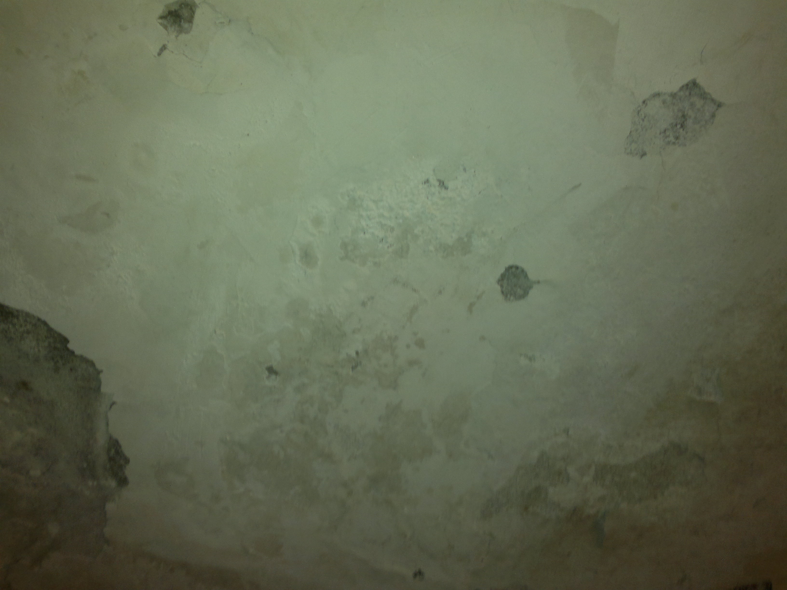

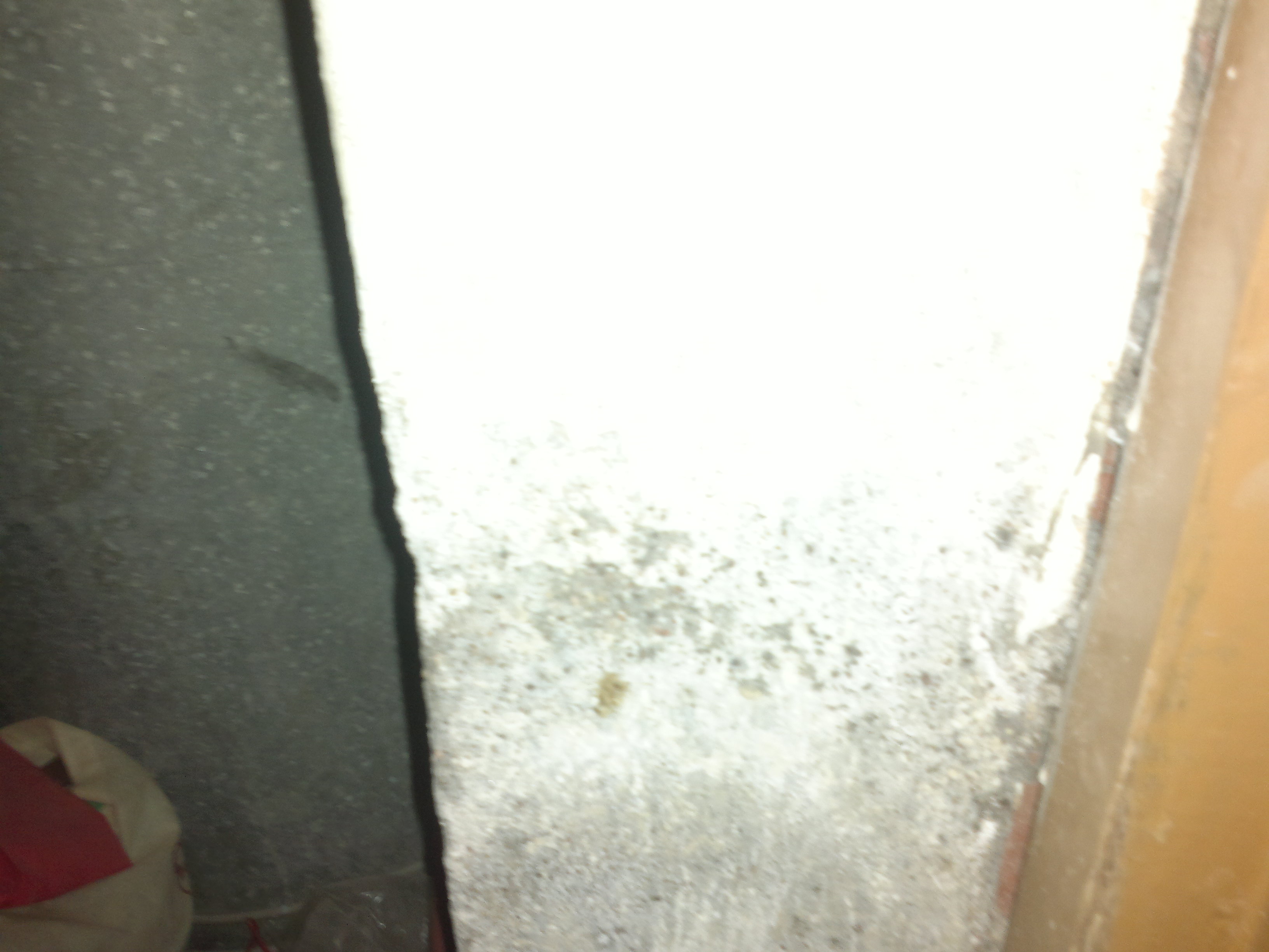

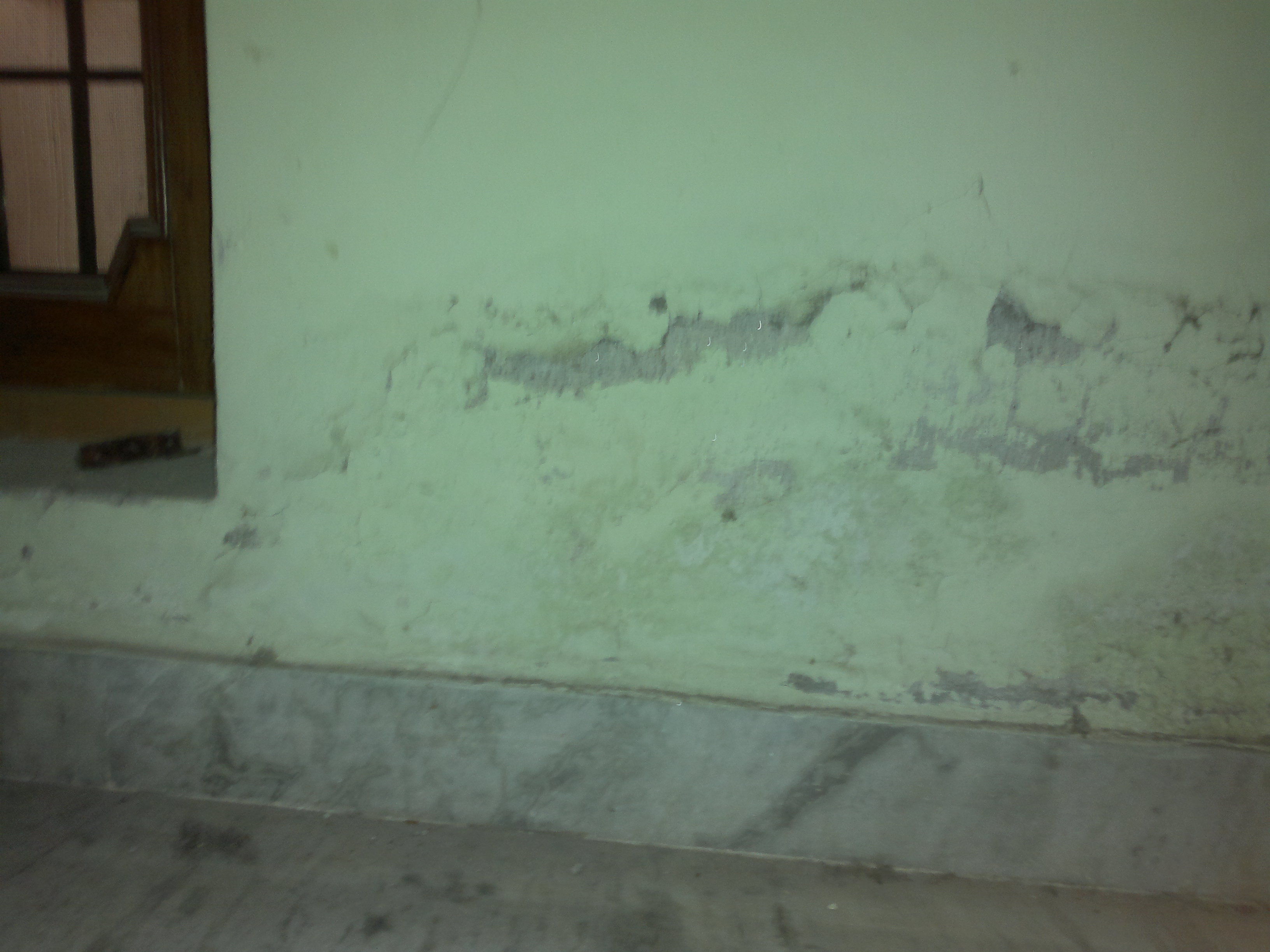

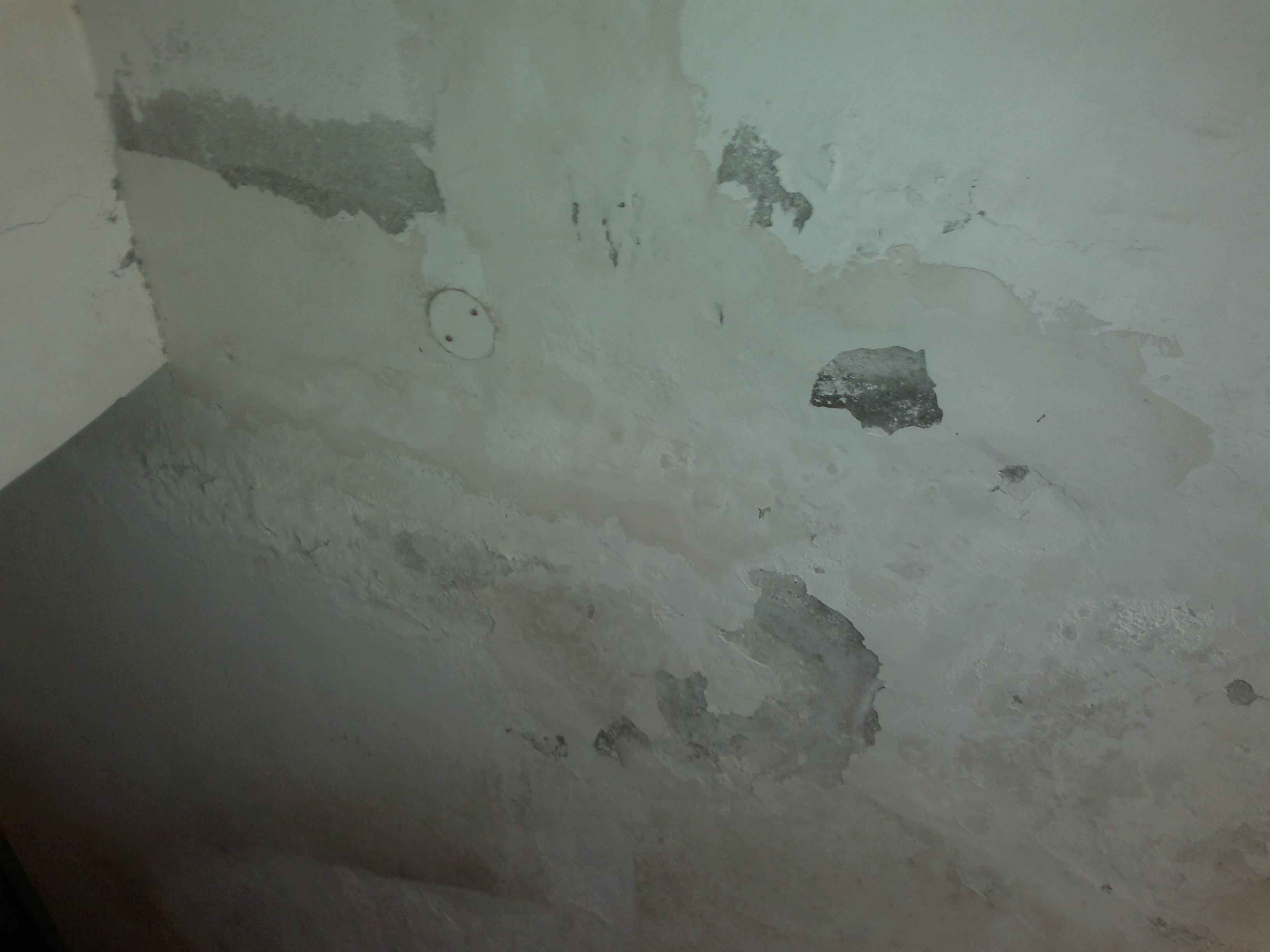

there are white color mold grown on the walls of the room. due to which the paint of room is falling and plaster is also falling in the form of dust.
can u please advice how to control mold.
i have also attached pics.
the area is being also repainted,but the problem was still there and paint started peeling off on its own
Attachments: 2014-04-18-049.jpg on Fri Apr 18, 2014,
2014-04-18-044.jpg on Fri Apr 18, 2014,
2014-04-18-046.jpg on Fri Apr 18, 2014,
2014-04-18-043.jpg on Fri Apr 18, 2014,&n
Tue Apr 22, 2014Post  #1
Dear Piyush
           This problem is due to salt presence in the bricks and plaster work. At the time of construction you use salty water in construction. It is very expensive to remove the salt. There are many product in market but they have no permanent solution.
  In my view you should remove the plaster, than wet the wall, when it dry than salt comes on the wall, remove it by brooming. Repeat this 2or 3 times. Than plaster the wall with coarse sand and cement but not use salty water.
