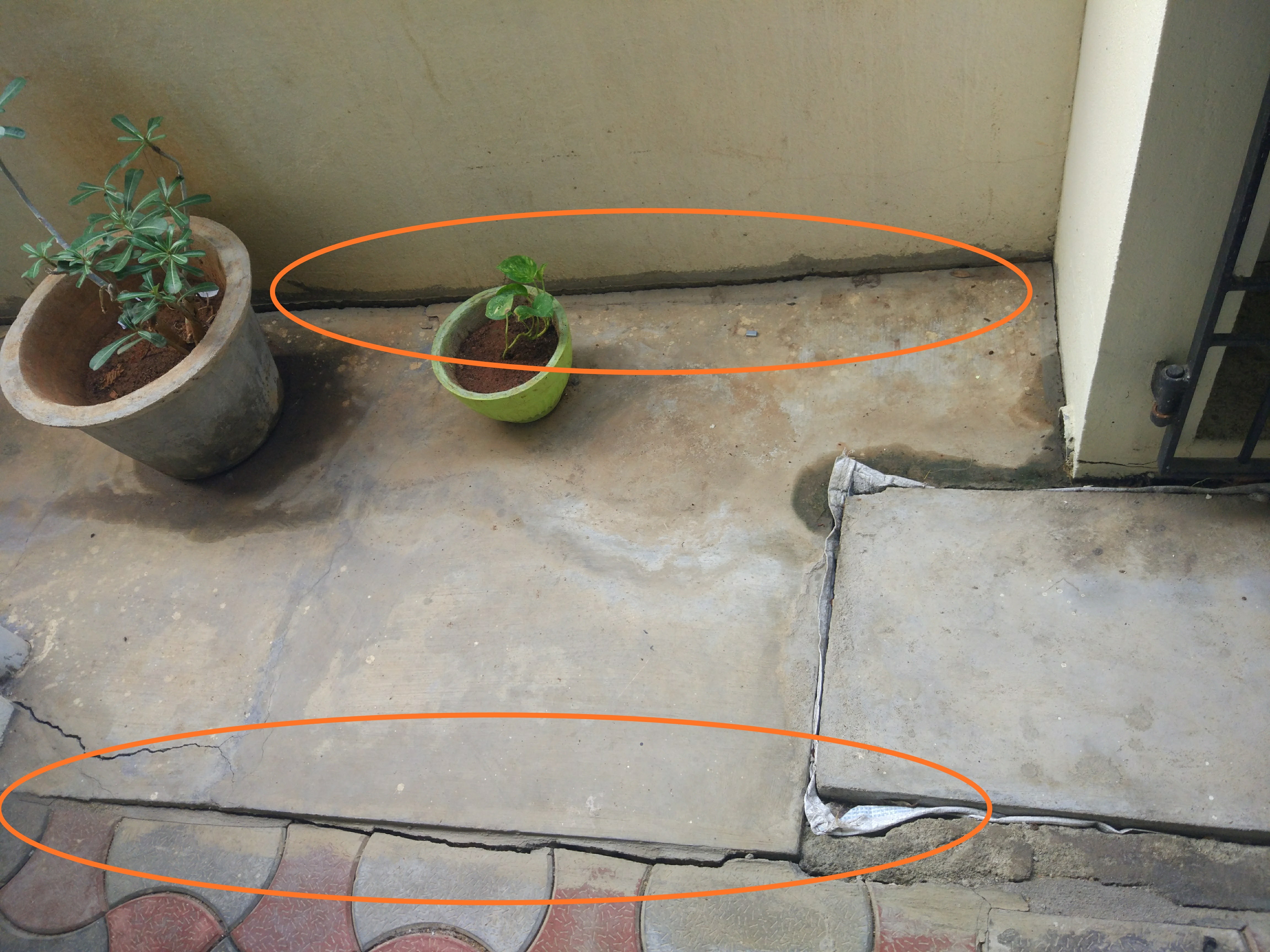

| Topic: How to fix the crack,please find the image.some one explain the reason and solut
How to fix the crack,please find the image.some one explain the reason and solution. |
Wed Sep 27, 2017 | Post #1 | Arun
Join date: Oct 2012 | Post subject: Image
Find the image. | | | |

Join date: Mar 2008 | Dear Arun.
Cracks can occur due to chemical reactions in
construction materials, changes in temperature and climate, foundation
movements and settling of buildings, environmental stresses like nearby
trains, earth quakes etc. Faulty design, bad quality materials, wrong
method of construction, weather effects and lots of wear and tear can
create cracks in walls, floors and ceilings. In my opinion
1 It is due to settlement of earth filling i.e the earth filled under floor is not compacted well and voids remain which is settle letter on. 2. Settlement of foundation. 3. There is possibility of water leakage from any water supply pipes or sewer pipe or from rainy water enter in the earth under floor which damages the floor and wall. For crack fixing you can take help from any good mason who will open the crack and fill it with cement and coarse sand mortar.This is temporary method but look ugly for the beauty of house. The second method is first find the cause than remove the floor and compact the earth under floor and lay the new floor.

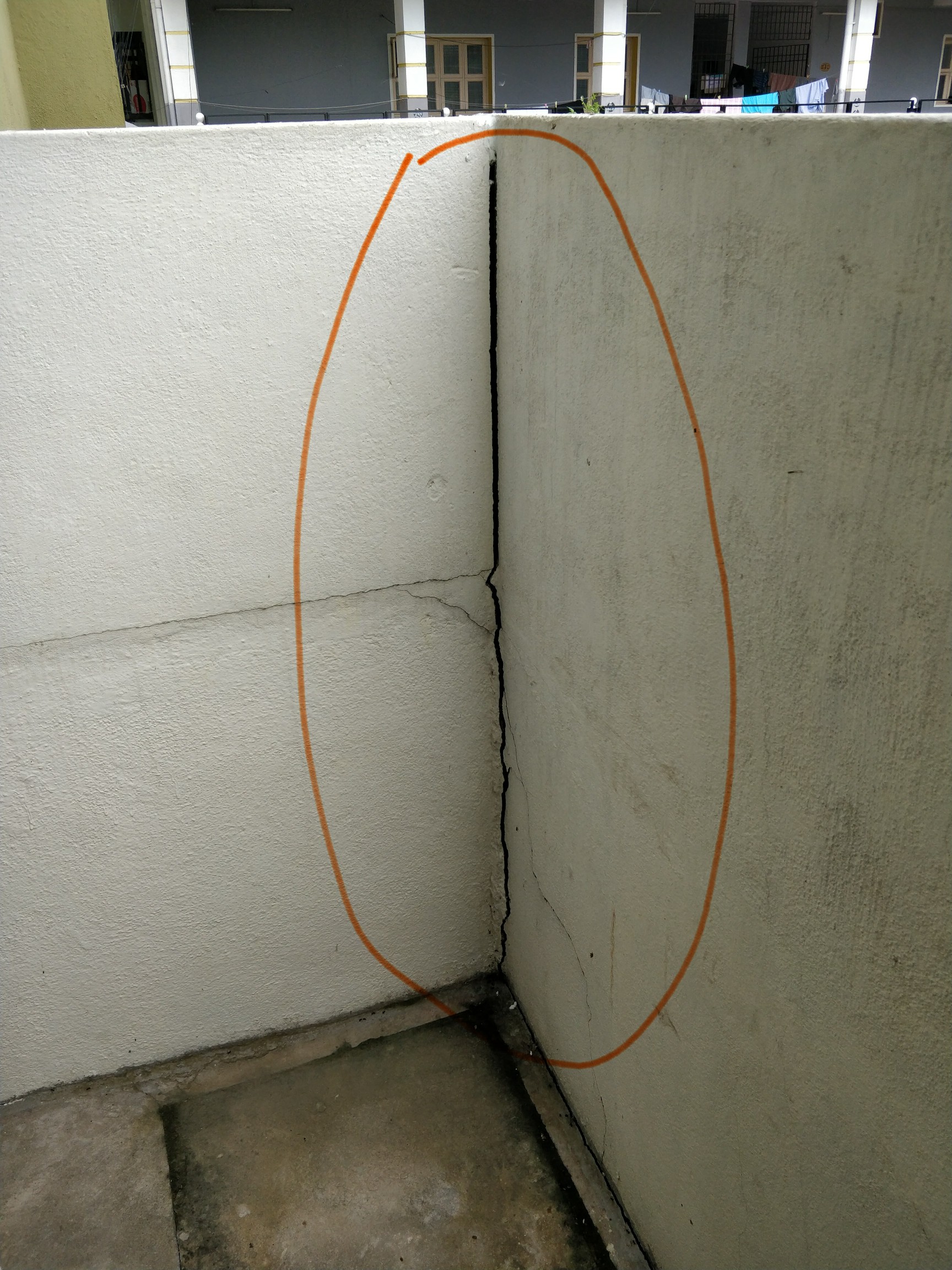

Join date: Oct 2012 | Post subject: compound wall expansion
how to fix the compound wall expansion?
find the attached image.
