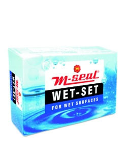

Post subject: I will guide you how to Repair your sump by your...
Hi, I am Aslaan Malik from bangalore, india...
first let me tell my experience in repairing leaking water sumps...Although i am engineer but i repaired our two sumps mentioned below in details..
First you have to notice from where u r tank is leaking, by noticing tank level every day.
Our 13 yrs old sump started leaking 10-12 inches every day in 2011, its nearly 500 ltrs every day....so what i did is, when there was no water in the tank i took a good torch and inspected and what i found is around 25-30 holes...i will tell you how i repaired it.
We constructed our new tank in January 2014...In beginning our constructors said its a new tank so it drinks water, just wait for few days it will be fine, but even after one month it did not stopped every day more than 500 ltrs was leaking....
Here also i took torch  &  i inspected and found crack in wall and holes below every plastic-rubber steps...
So what is the solution...I fixed it in Just Rs.60...shocked here is the solution..
1)you must be heard of M-Seal which u can easily found in any hardware shops, buy it as per your requirement.
2)It comes in two solutions u have to mix it, just follow the instructions on m-seal box.
3)clean the surfaces where u have to apply m-seal, like cracks or holes.
4)now apply m-seal, but dont use water, if its very hard u may use just 2 or 3 drops water.make sure all holes or cracks are filled, for better fillings use u r thumbs and gently press the m-seal.
5)leave for drying for atleast 6 hrs, fill tank and check u r problem solved.
Thanks
Mohammed Aslaan Malik
Attachments: 337.jpg Wed Mar 12, 2014,&n
