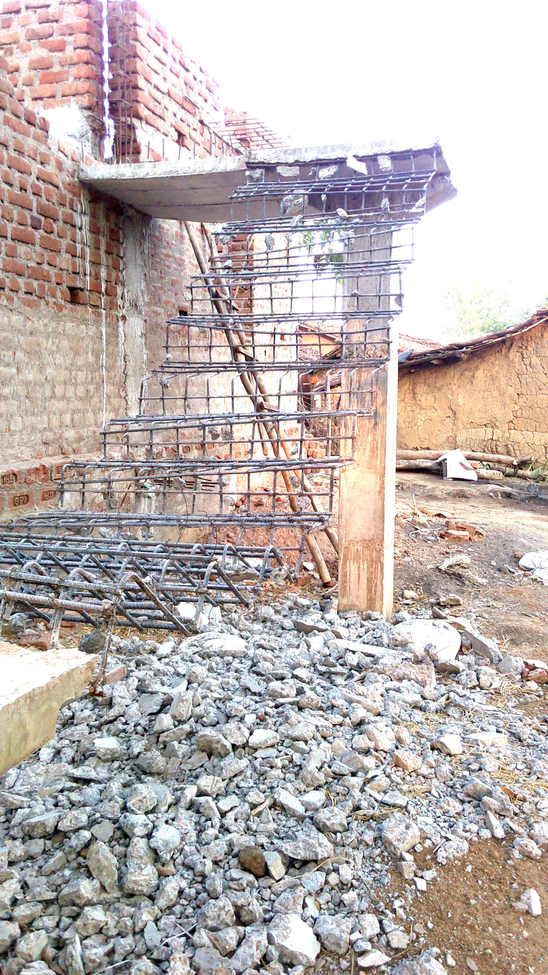

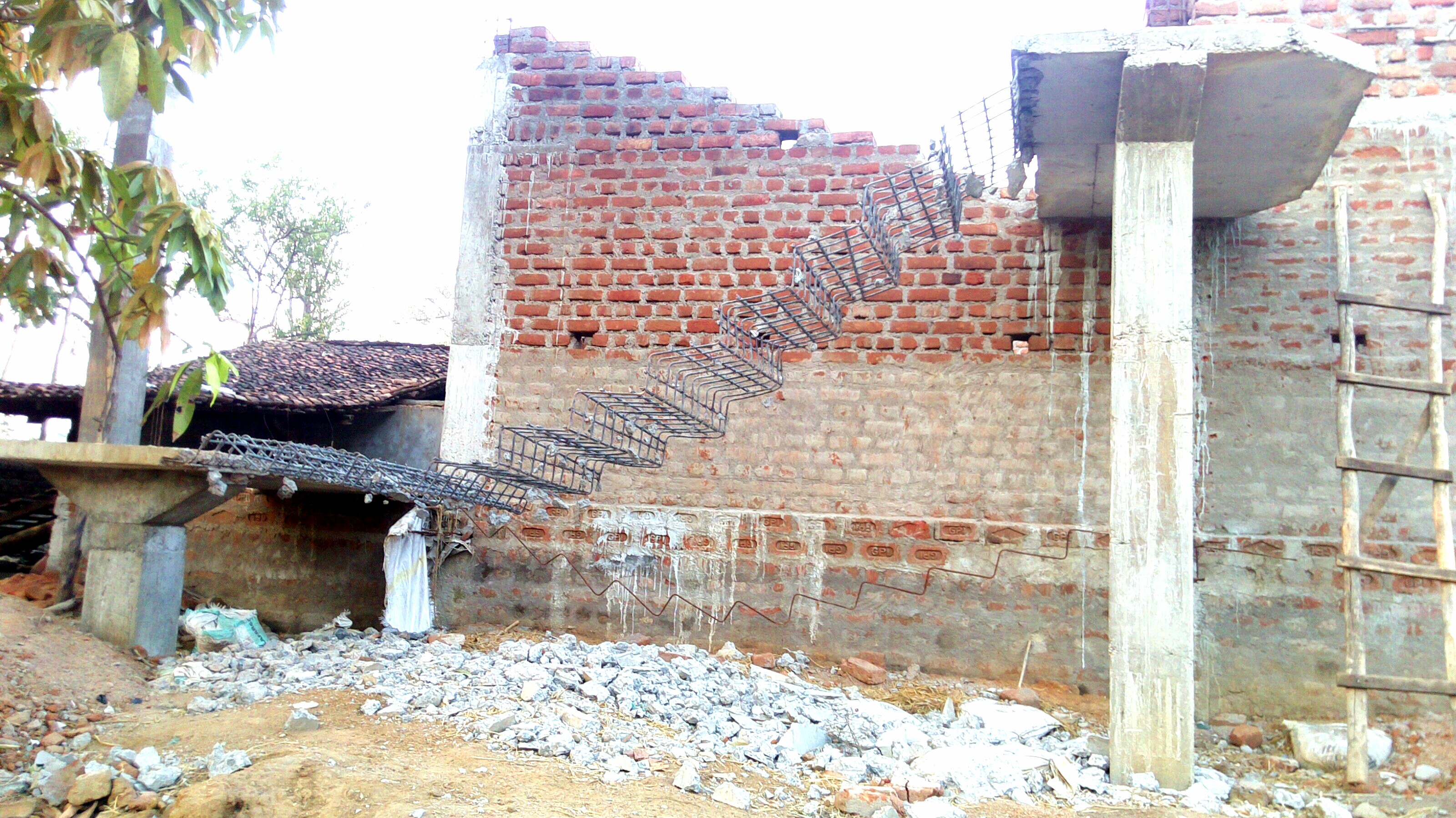

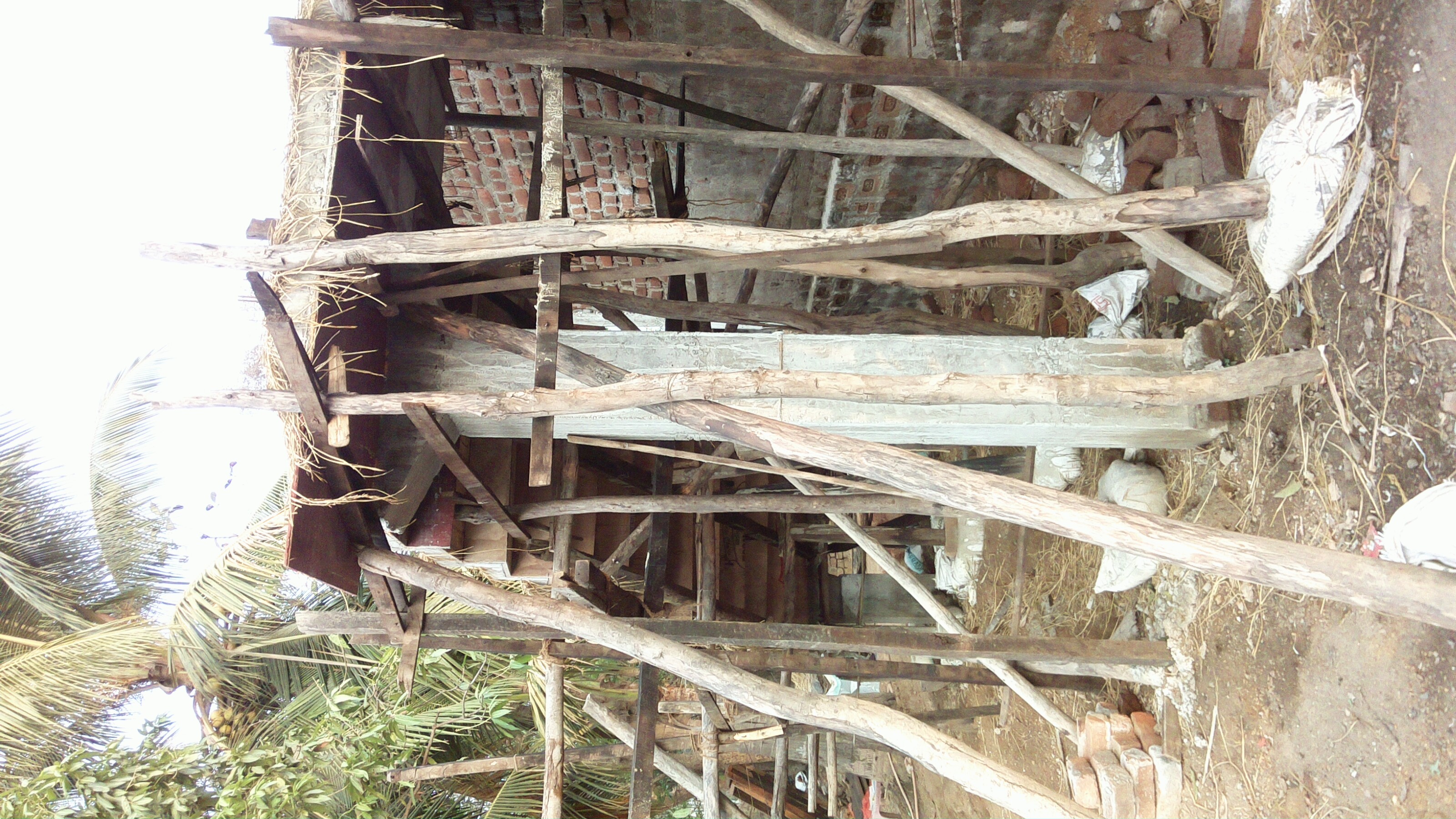

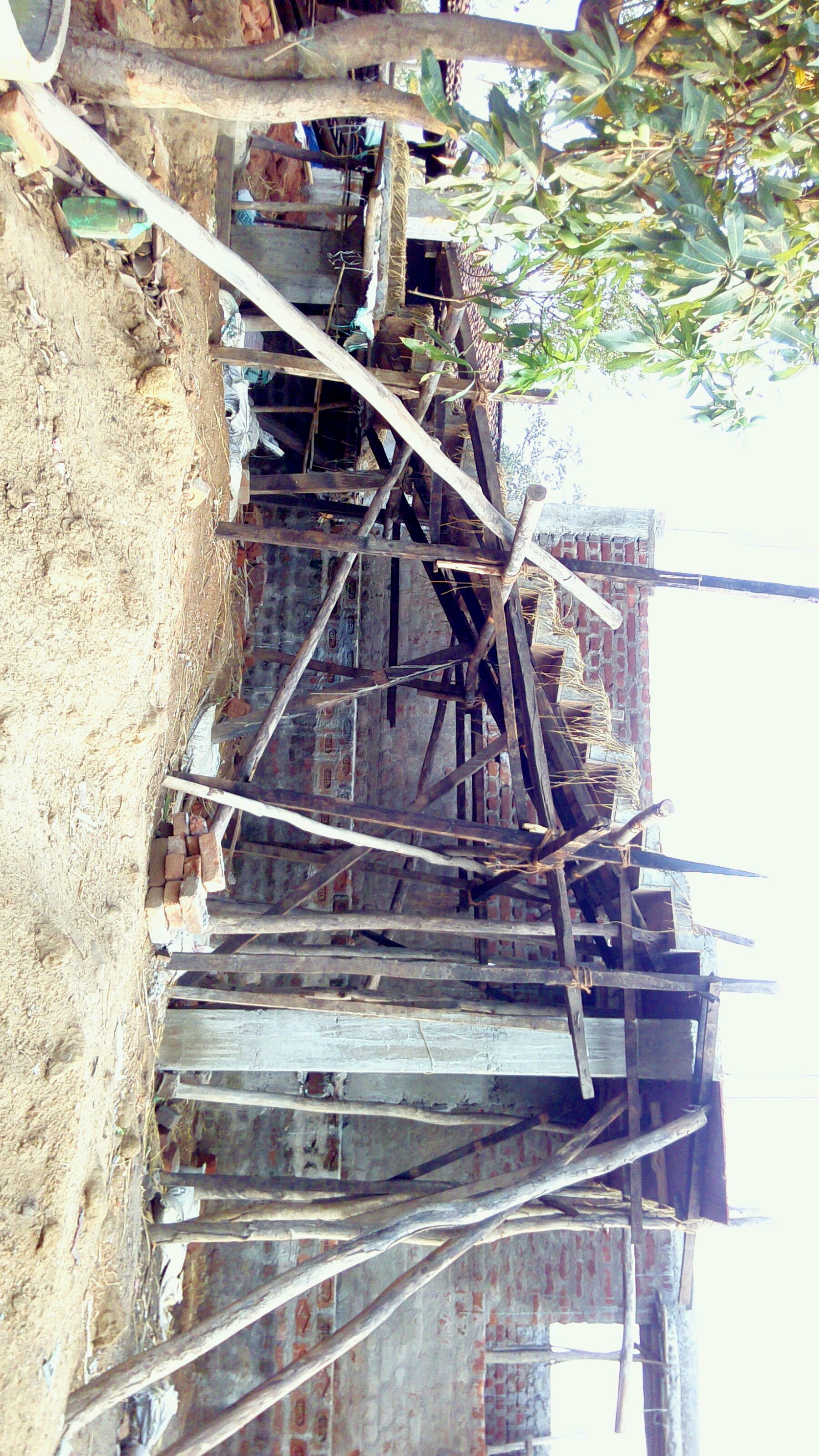

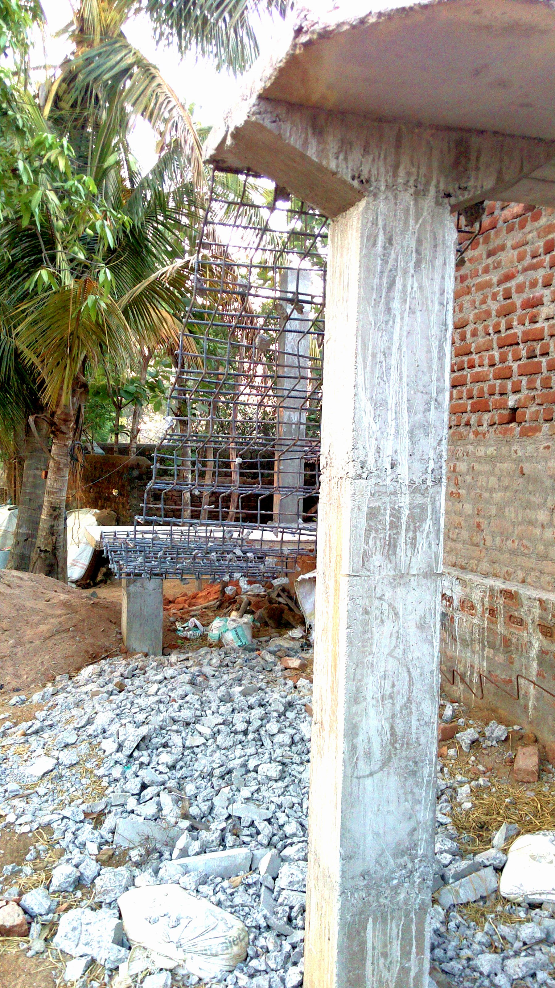

After construct this staircase have been broken down. How can be renovate this broken staircase and what's the problem in this construction ? Please give me some solutions for that.
Length of the staircase is 12 foot and breadth is 3.5foot.
Attachments: IMG_20160422_155737.jpg on Sat Apr 23, 2016,
IMG_20160317_171118.jpg on Sat Apr 23, 2016,
IMG_20160423_061851.jpg on Sat Apr 23, 2016,
IMG_20160423_061715.jpg on Sat Apr 23, 2016,
IMG_20160423_061619.jpg on Sat Apr 23, 2016,&n
Mon Apr 25, 2016Post  #1
Dear Naik
       In my view the mix of cement concrete ratio is not proper and at the time of laying the concrete is not mixed properly either more wet or used dry for finishing. Also MS Steel bars are not correct.
Now it is advisable to take help from local engineer of your city who can guide you better at site.
