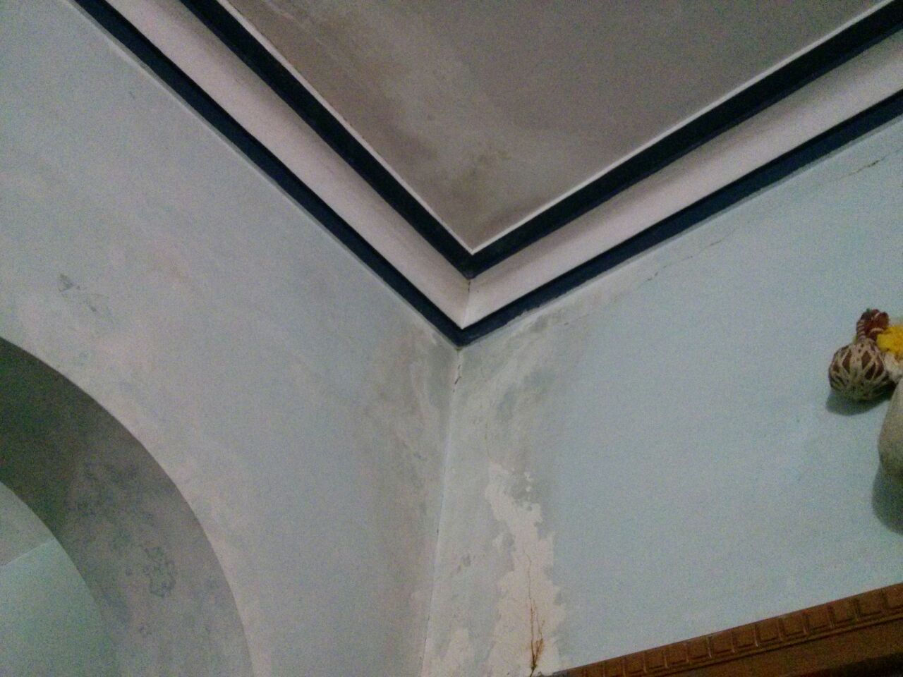

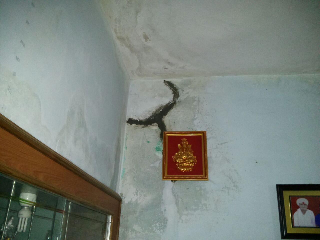

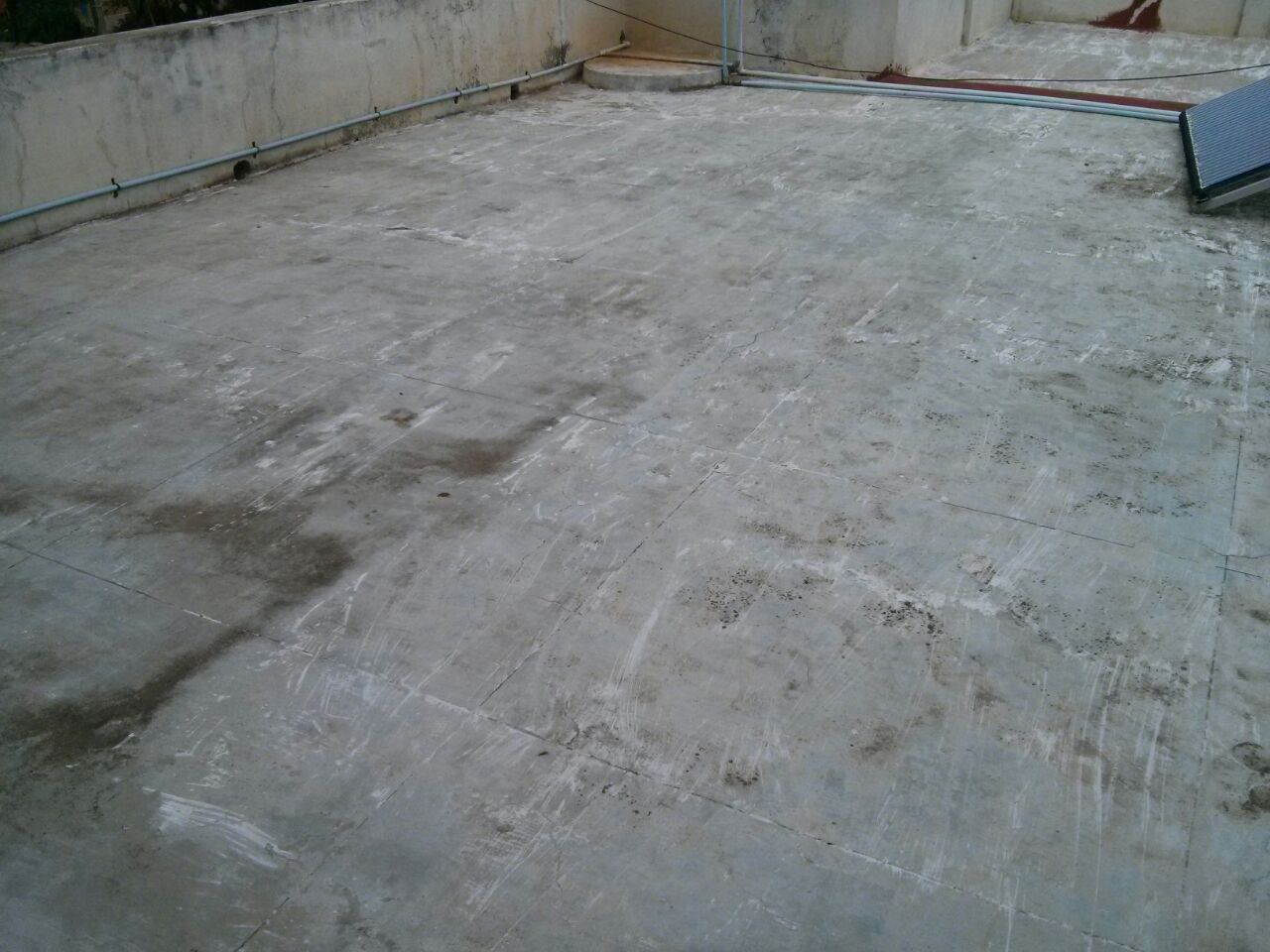

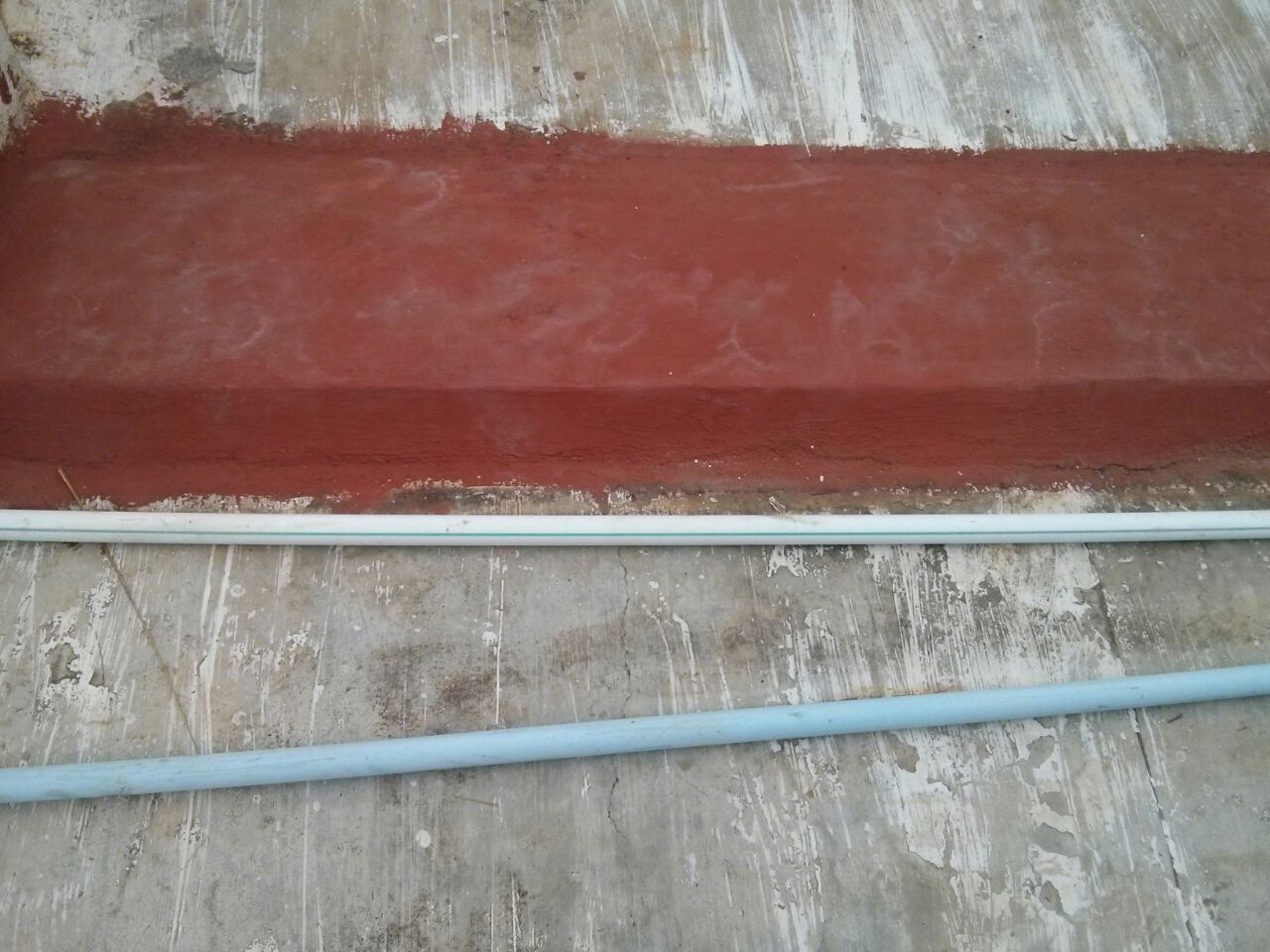

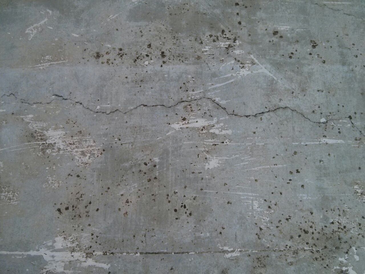

my house has a leakage problem and dampness in wall. house located in medium rain fall area and here i am attaching some photo of terrace and inside wall where dampness. please sugest me which is the best chemical for water profing treatment.

Use liquid silicon which will fill the gaps and also will provide a waterproof coating for future.
Mon Apr 20, 2015
Dear Chethan
In my opinion the finishing at terrace is defective. Check the joint of tile terracing at roof.
Remove the tiles which are settle down and relay after cleaning the area.Also check the blockage of rain water pipe.
