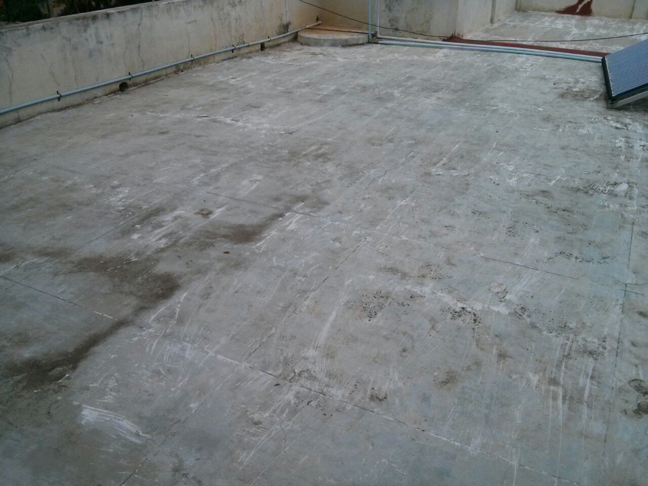

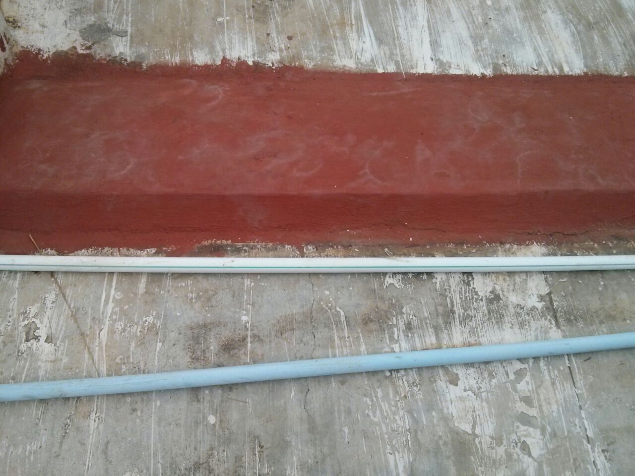

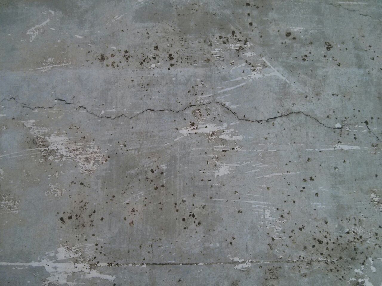

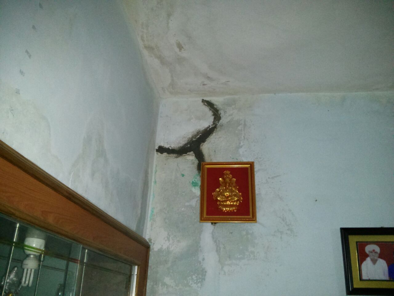

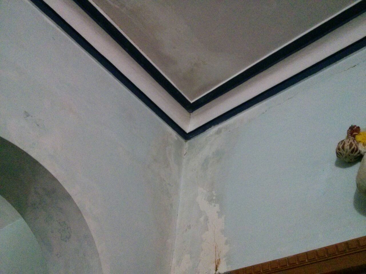

sir
my house has a leakage problem and dampness in wall. house located in medium rain fall area and here i am attaching some photo of terrace and inside wall where dampness. please sugest me which is the best chemical for water profing treatment.
IMG-20150419-WA0010.jpg on Sun Apr 19, 2015,
IMG-20150419-WA0017.jpg on Sun Apr 19, 2015,
IMG-20150419-WA0014.jpg on Sun Apr 19, 2015,
IMG-20150419-WA0039.jpg on Sun Apr 19, 2015,
IMG-20150419-WA0036.jpg on Sun Apr 19, 2015,&n
Sun Apr 19, 2015
Post subject: Water Proofing
Hello..! Mr.Chethan, Kindly check following points..1.Storage of water on terrace.There should not be any storage of rain water,make it correct by levelling and cleaning of outlets.2.Repairing of damaged flooring & projections if any, check it. 3. check Leakage of Sanitary or water pipe lines ,5.Take help of an experienced Water proofing applicator .hope it will solve your problem..Regards
Mon Apr 20, 2015
Use liquid silicon which will fill the gaps and also will provide a waterproof coating for future.
