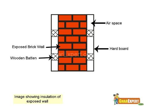

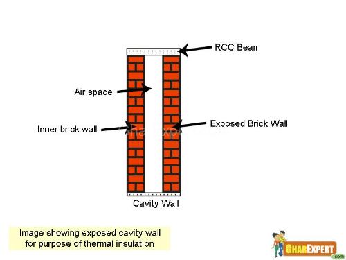

Thermal Insulation of Exposed Walls
The heat and cold radiate through exposed walls of the house. There are following methods of thermal insulation of exposed walls.
1. You may provide suitable thickness of wall.
2. You may provide Hallow wall or cavity wall.
3. You may fix Hardboards or ply board on wooden batten over the wall for creating air space.
4. You may fix Thermal insulating material sheet inside and outside exposed wall to reduce heat/cold transmission.
5. You may construct outer wall with thermal insulating material if you have frame structural building or non-load bearing walls.

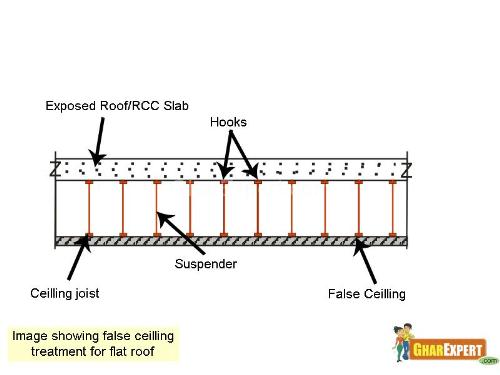

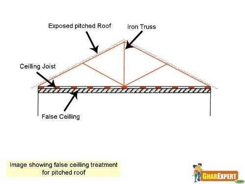

a) Internal Treatment:
1. You can treat both types of slabs both types of slabs either flat roof or pitched roof.
2. You should provide Air gap for under exposed surface of roof by fixing false ceiling under the roof.
3. Ventilation abutting the roof also helps for passing the heat out of the room.
4. You should install false ceiling with thermal insulating materials.
5. You may paste suitable adhesive and sealers at inside surface of the exposed roof for fixing Light insulating materials. Some insulating materials are glass wool, fiber glass wool, mineral wool, thermocol, rubber foam etc.

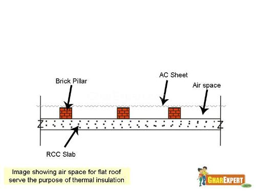

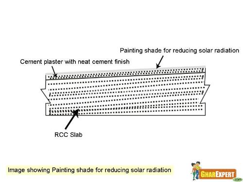

b) External Treatment:
 Suitable shade may be provided on exposed top surface of the roof for reducing solar radiation.
2. Shining and heat reflecting coating may be applied on the top of exposed roof like paint.
3. These coatings can serve dual purpose of water proofing and heat reflection.
4. In case of flat roof you can create air space on top of roof by placing asbestos sheet on brick pillars.

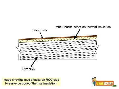

7. ‘Mud Phuska’, which is a mixture of clay soil, wood shaving, and water, should be laid on exposed roof acts as thermal insulation.
8. The earth laid under tile terracing on top roof also serves the purpose of thermal insulation and helps in giving proper shape for drainage of rain water.
