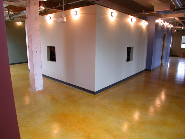

Join date: Mar 2008 | Dear Aammiitt In cement concrete flooring, when we need shade of any color in flooring then following instruction should be followed. 1.Fix glass stirrups in floor for making panels as usually done in all concrete flooring. 2. Lay cement concrete in panels for flooring. 3. Mix floor color of required shade in cement and apply this mix by making cement shullary on the already laid concrete and finished the surface 1st with wooden float than with iron float.

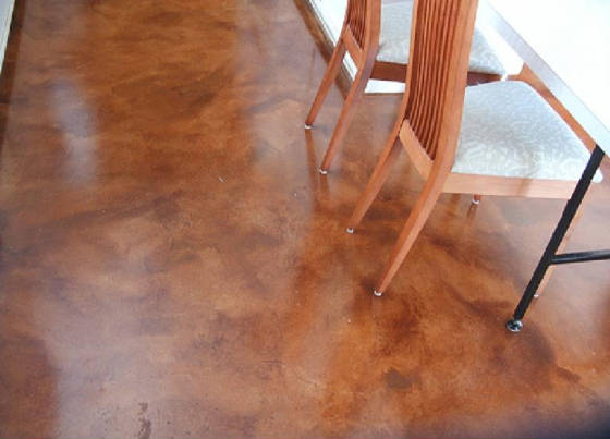

thanks a lot sir! however, do you think the effect would come as in the image attached above, if i use glass stirrups......! kindly advise
regards, amit | |

Join date: Mar 2008 | Dear Aammiitt Glass strips/ aluminum strips are used for making panels in the floor. By making panels there is no any chance of cracks in the floor and they have good appearance in the floor. If there is any damage than one panel can easily be replaceable.

but gupta sir.....how will i get an effect like the images attached above.....please request you to guide you more | |

For getting the finsh shown in the picture than lay floor without glass stirups or with this color stone flooring. | |
