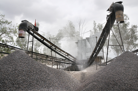

Dear All,
Can we use Artificial sand for house construction. Sand which is a by-product of stone crusher. also known as stone dust. What is strength of RCC roof as compared to River sand.
Attachments: Stone srusher.png on Tue Apr 08, 2014,&n
