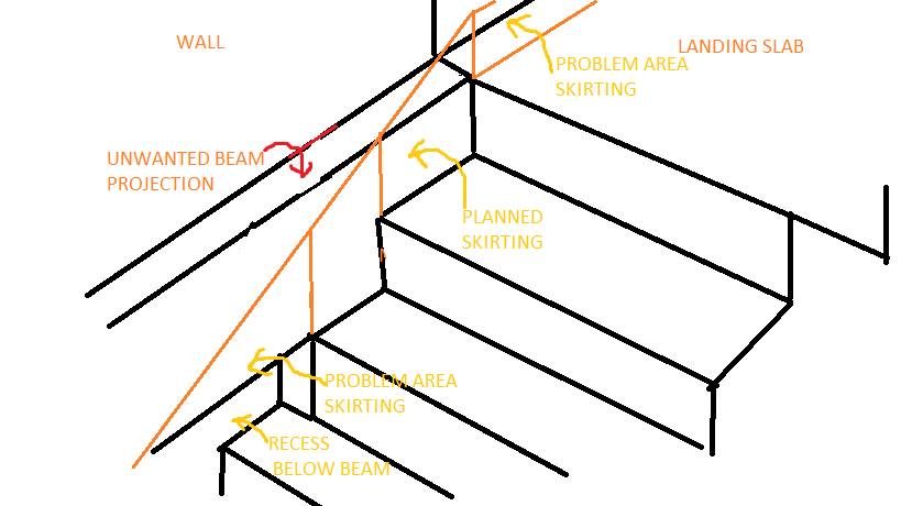

Hello, a staircase was planned with kotah stone treads, risers and skitrting. All were to be wet cladded. But a Floor Beam has projected inside the staircase at the landing slab. this has eaten up 100 mm of stair width at the top three steps. And created a recess below the beam for the rest of the steps of this flight. So, the skirting of 150mm high that was planned on the wall surface of the staircase cannot be wet-cladded onto the wall because of this in-out-in plane of wall. Is there a cost-effective way of furring out the skirting cladding away to hide the beam projection. Sorry for the terrible sketch as I had only MS paint installed on this kaam-chalau laptop. thanks.

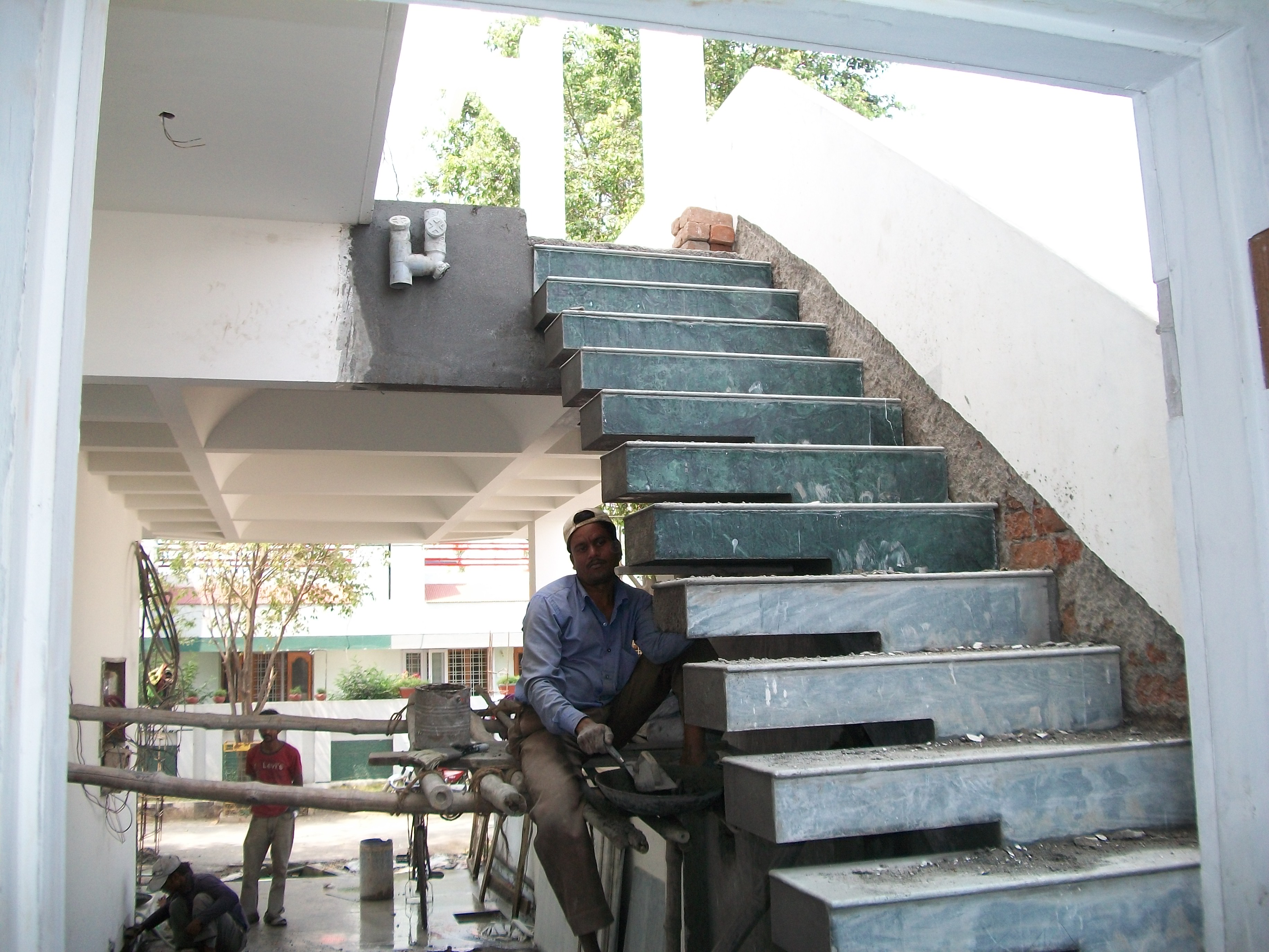

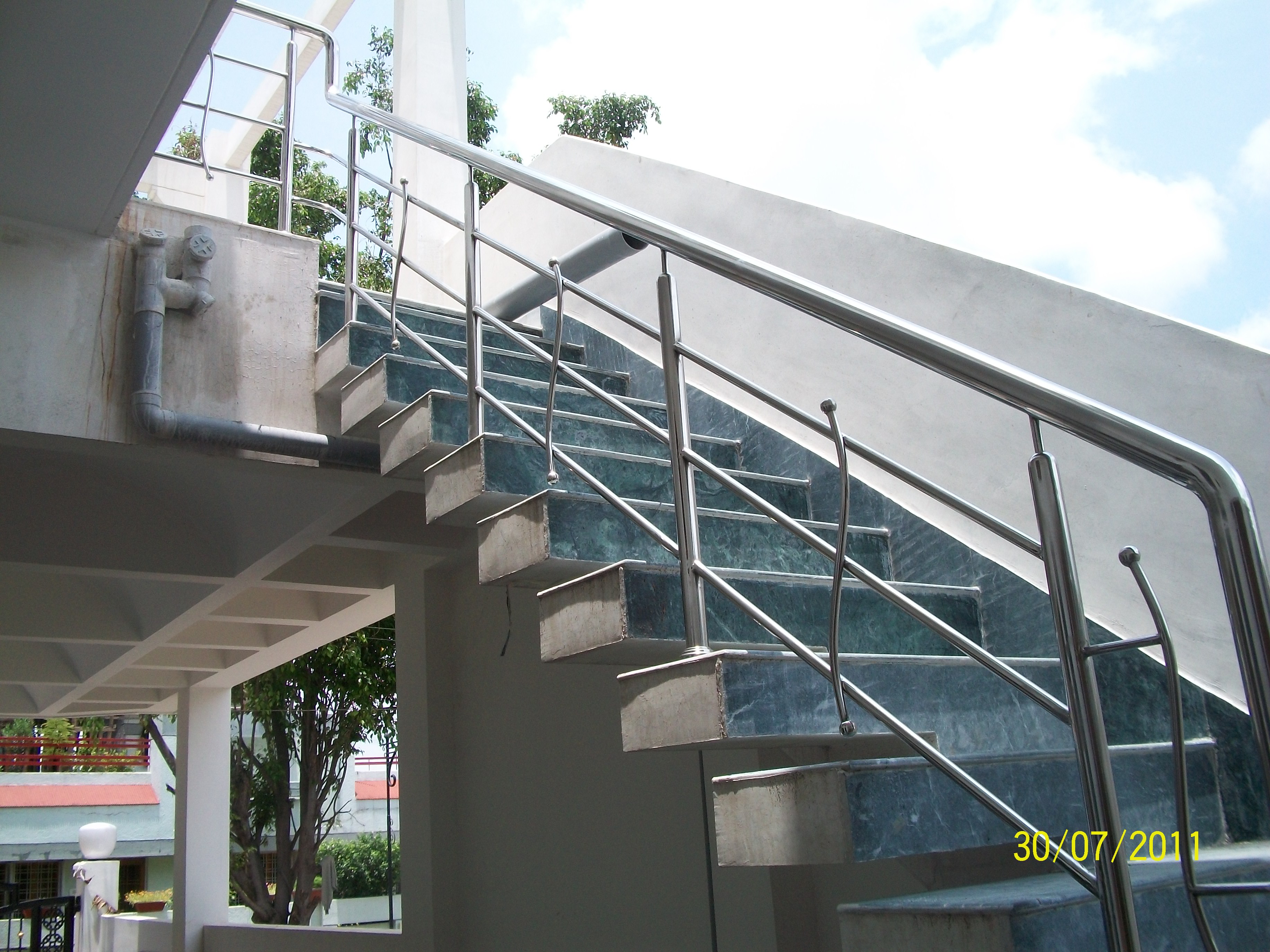

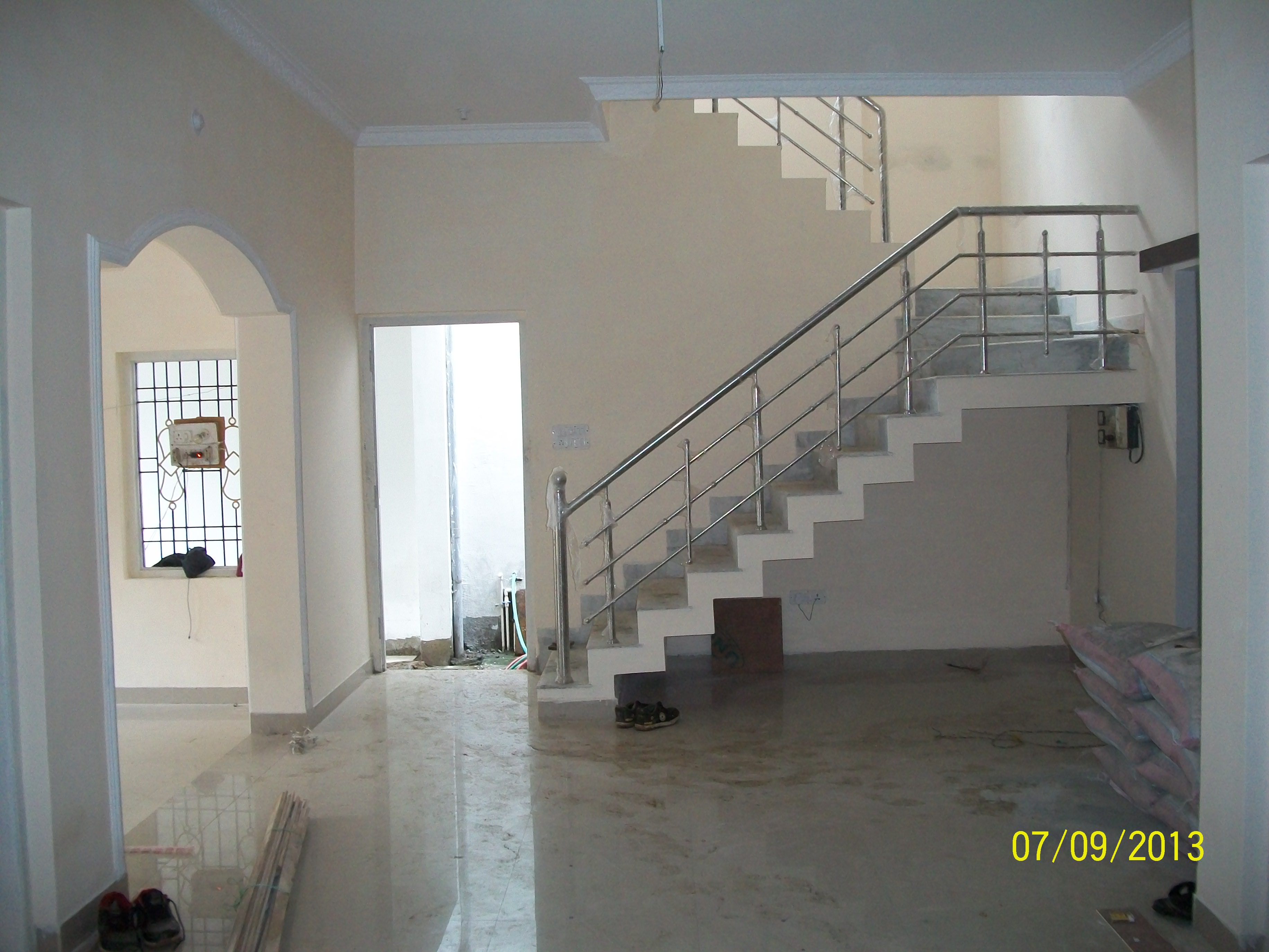

Hello..! Durva Mayee, The staircase should be planned by keeping Thickness of flooring material in mind . such type of problem may occurs on projected landing , it need a special attention during planning...a Good sketch on MS Paint gave a clear idea...about ....Kindly see attached files for skirting on landing (Zoom it)...regards.
