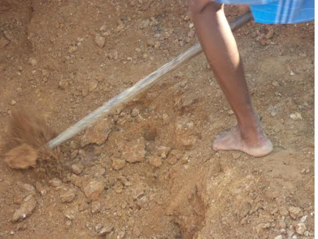

Respected Gupta Sir
Thank You very Much for your Valuable Information sir.
You have asked about "There is need of beam in hall of the building
But Your mentioned beam is "Roof Beam or Plinth Beam "??
Suppose If It belongs to "Roof Beam" , Room Beam will come at all 9" walls as like as Plinth Beam Drawings. So Plinth Beam and Roof Beam Drawing is Exactly Same.
Also At Plinth Beam drawing's , I have mentioned Dia 16 mm -5 Nos with Center Cranked . But Instead of , I would like to change Dia 16mm -4 Nos & Dia 12- 2 Nos
Which is Best Sir??
Thank You
Center Line Details.pdf on Thu Dec 05, 2013,
Plinth Lintel Column Details.pdf on Thu Dec 05, 2013,
Soil.jpg on Thu Dec 05, 2013,&n
