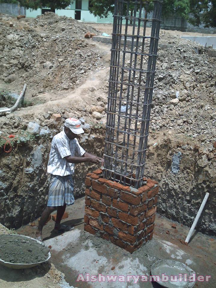

Dear Friends,
I have seen Brick work instead of Formwork for pedestal in Building Construction. How it will suitable?
943927_951042961642579_6830342394583202860_n.jpg on Fri Feb 19, 2016,&n
Wed Feb 24, 2016
Dear KM
Temporary Brick Masonry Shuttering
In some cases labor contractor uses Temporary Brick Masonry in mud for vertical support of sides of beams, fascia etc. This shuttering should be avoided. This type of shuttering reduces the strength of cement concrete by soaking cement slurry. Also no proper compaction is made as this shuttering does not bear the pressure of vibrator. The surface of cement concrete given by this type of shuttering is uneven and the thickness of plaster is increased
