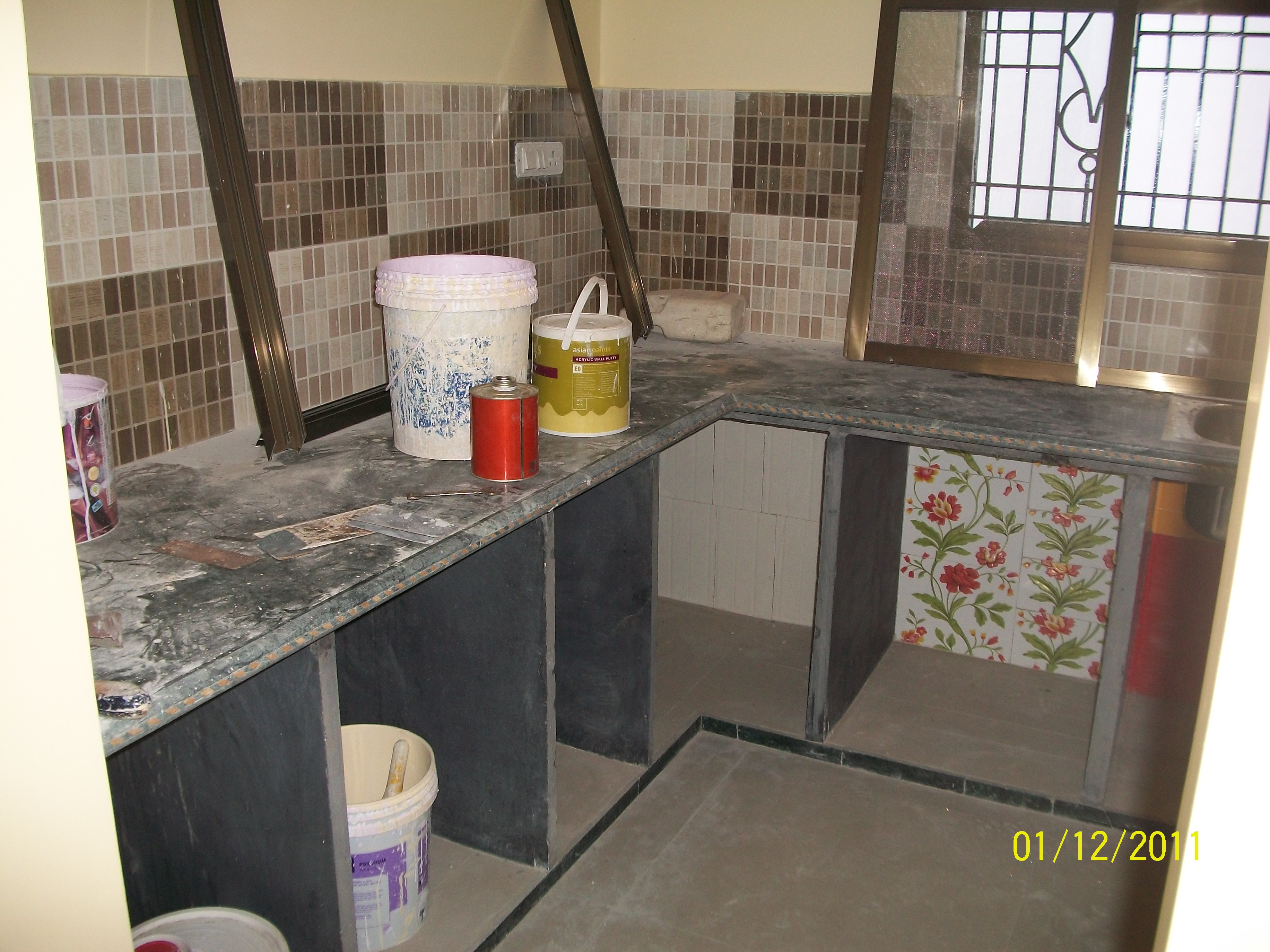

Hello..Mrs Francis...Its a good idea ,to use granite for Shelves.. marble is not strong enough for long span, a polished Kadappa stone can be used for Kitchen partitions as wel as shelves, it is economical , safe and durable...regards
Attachments: 100_1567.JPG Sun Mar 23, 2014,&n
