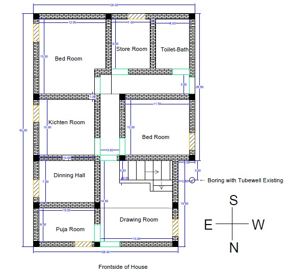

Dear Gupta Sir,
I have attached layout plan to construct two storey  house.
Kindly suggest the column size for the house and the position of column.
Giri

Dear Giri,
          The size and MS Steel is calculated on the basis of loading and bearing capacity of soil by structure engineer. However the placing done by you seems correct, take 9''x9'' column with 4 nos 16 mm dia bars of MS Steel.

I have doubt on column between 9"x9" with 4 no of 16mm mild steel bar and 9"x12" with 6 no of 12mm mild steel bar for G+1 storey house.
Incase the distance between two column is 15 feet. which will be the better option to choose the column size.
9"x9" with 4 no of 16mm mild steel bar or  9"x12" with 6 no of 12mm mild steel bar.

Dear Giri,
      If you want to place column at 15' distance than take the size of column 12''x9'' with 4nos 16 mm bars at corner and middle 2 nos bars of 12 mm.
