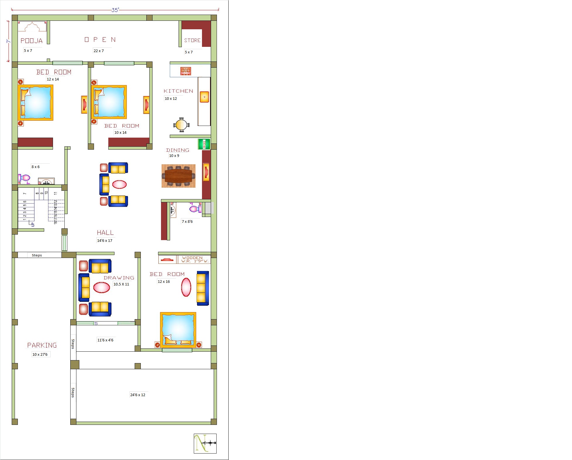

Please Estimate the cost of RCC roofing for attached map.
Attachments: PraveenMap.jpg on Tue Dec 10, 2013,&n

DearPraveen
              The cost of RCC slab 5'' thick with cement concrete 1;1.5;3 is Rs 125 to 140-00 per sqfeet including the cost of MS steel bars and centering and shuttering.

Thanks Mr. Gupta,
Thanks for your quick response.One more help i need from you.
I need to apply the home loan form attached map.
I want to calculate the approx cost for this construction.
Can you provide some idea how much cost it will take.
The labor charge in our area is 145 sq Feet. including flooring & shuttering.
I want to build this plan on RCC beam. the plot is 3 feet deep from road & i want to have it 4 feet above from road.
