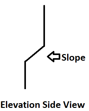

There is 9ft wide and 3 ft tall slope on front elevation.
We had installed 8inches* 4 feet vitrified tiles(planks) on remainnig area
The contractor has refused to install on slope stating the tile WILL fall from the slope while installing or after installing.
Even used myk laticrete adhesive And he is still refusing to install there with it.
What can be done.

Make a frame of iron in the same area like we use for the installation of stone if adhesive or cement doesn't work, but it should work and the labour has to hold it for a long duration due to which they refuse or charge higher amount.

umm.. stones are installed directly with cement/adhesive here.. no use of iron frame. So dont know what is this and its done.
Is there any article on the forum where i can get some info regarding the iron frame, or could you please elaborate more.

U can ask any welder for the frame of iron to hold the stone on wall, they will have a visit and check it whether it is possible or not, If not then you can use fasteners to hols the stone.
