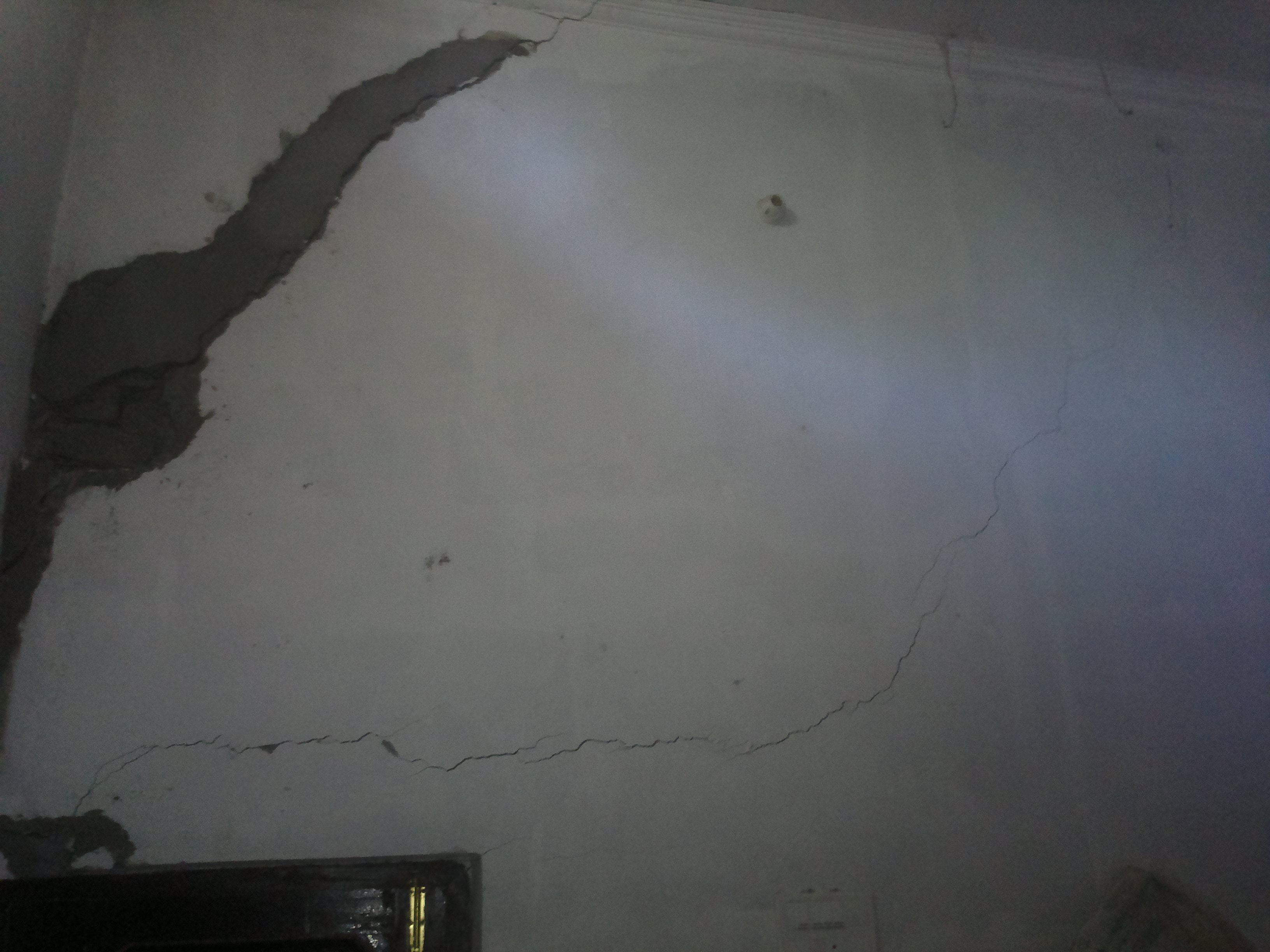

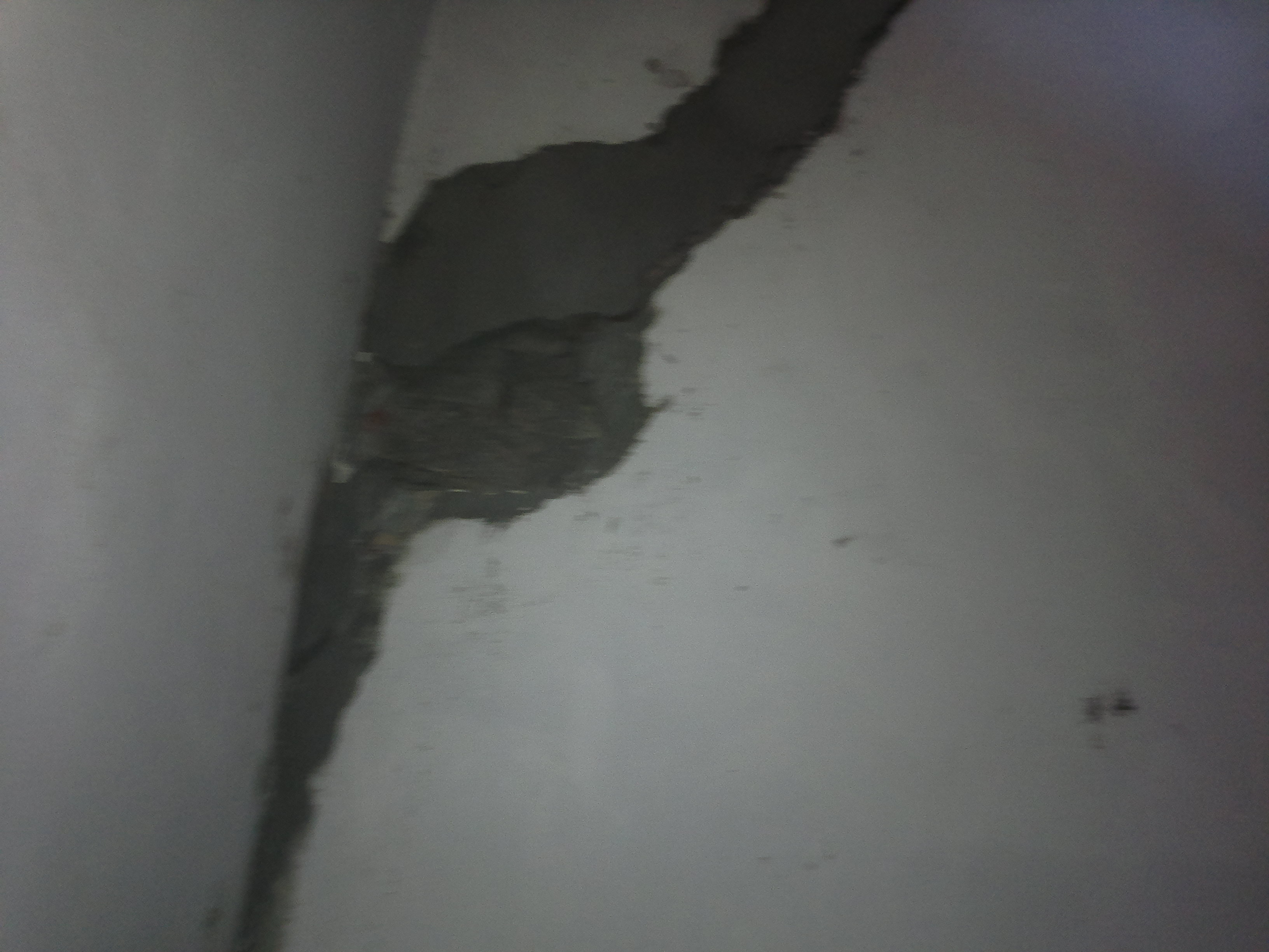

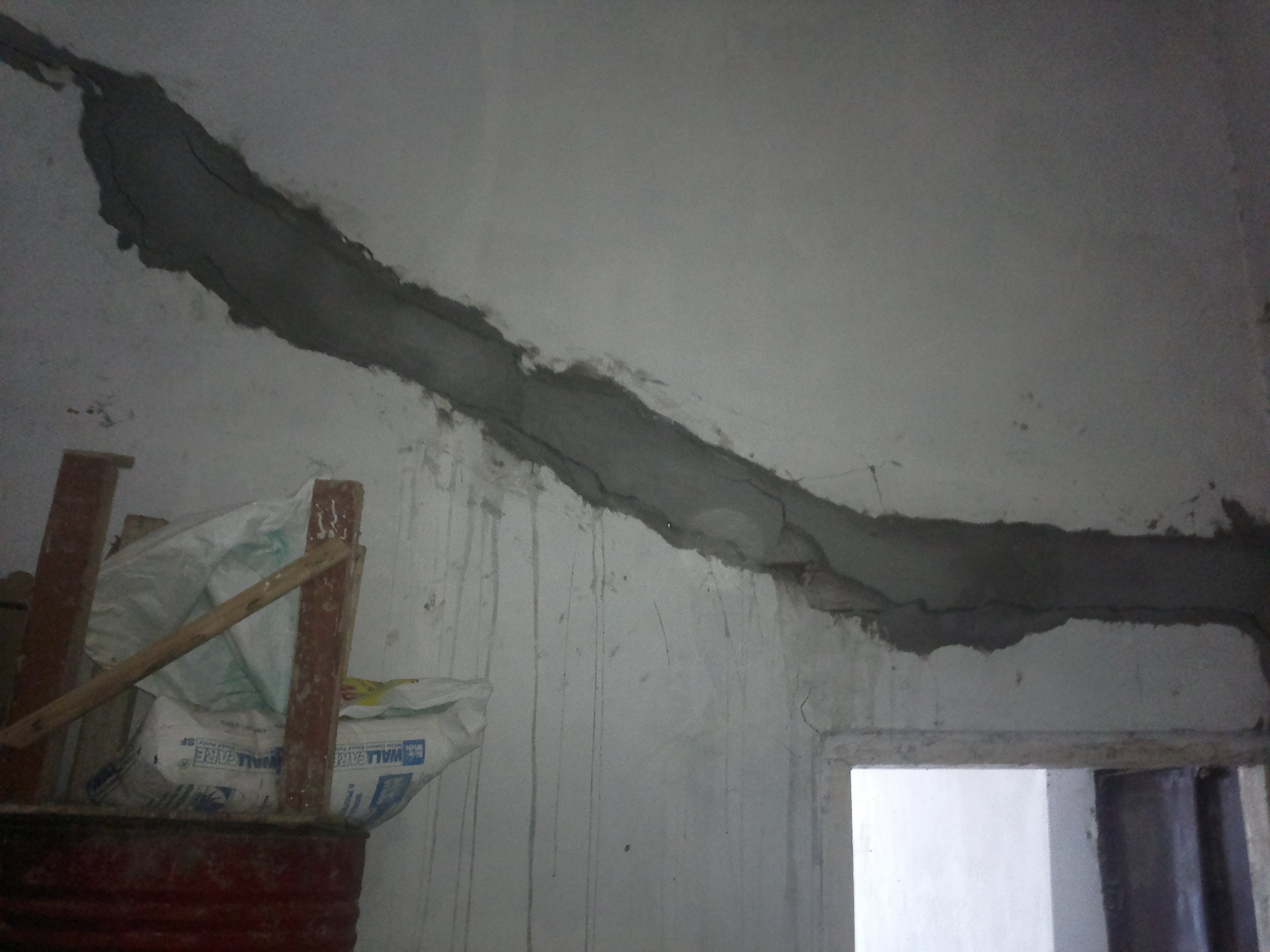

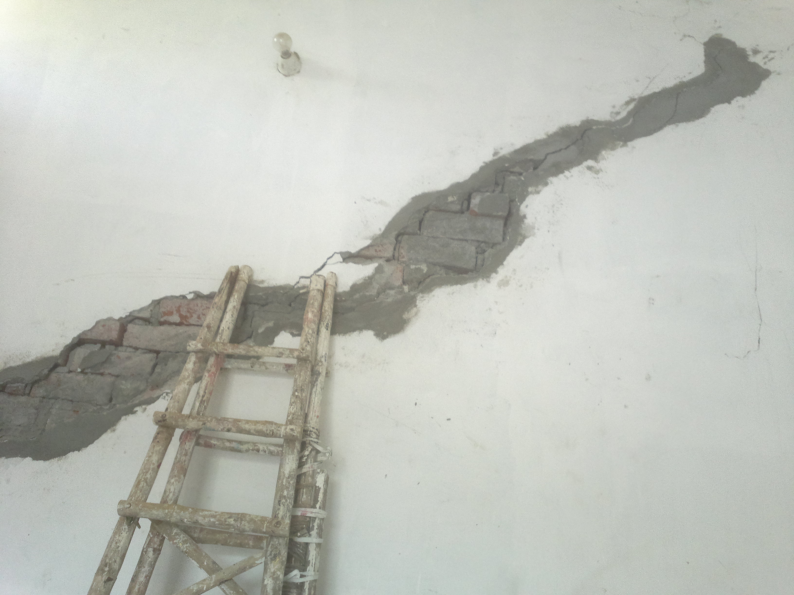

Dear Gupta sir,
Kindly suggest, how to prevent these cracks.. Cracks are in all parallel walls  and in same direction of thye building.

Tue Sep 03, 2013Post  #1
Cracks can happen due to foundation movements or settlements of a building. They can also occur due to thermal movements, chemical reactions, elastic deformations or shrinkage etc. They can damage plaster of walls, ceilings, destroy the beauty of the structure and can also be dangerous. GharExpert provides you extensive information about how to repair cracks, the causes of cracks, tips to prevent cracks and guidelines to prevent cracks in the building. There are 9 nos articles for repair of cracks SEE the link below.

Thanks for revert, Sir have found its coz of movement in foundation in main wall . kindly suggest how it can be cured as it is 3 floor building and cracks are in all 5 attached walls not in main. as shown in attachment

    Remove the crack area broken bricks
Before doing any repair of cracks, make sure that the cracks are stabilized and are not widening further. Remove broken bricks by scratching cement mortar from the joints gently.
Prepare the surface
All loose material should be cleaned from the portion by brushing and washing. Wet the surface 24 hours before application of new plaster.
Lay MS bars with cement concrete and fix new bricks thoroughly
Lay fresh cement mortar with coarse sand in 1:4 and fix new bricks. Fill all joints around bricks with mortar tightly with the help of iron tools.
Do curing and finishing
The repaired surface should be kept moist up to 7 days.  When surface is dry, it should be finished according to adjoining area.
Take help of good mason for repair and if possible than make visit of civil engineer for site inspection and advice for possible guidance in repair work.
