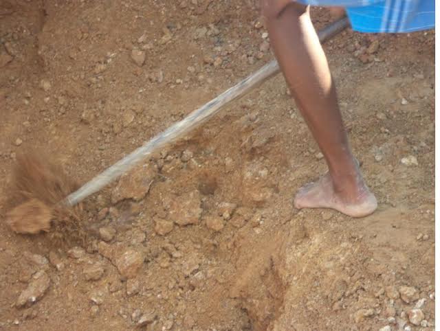

I have attached my Center Line Details, Plinth, Lintel and Column Details for G+2 Designs
Please Verify and Give comments.
Soil :  Medium Gravel Group

         In your drawing you have not shown the beam position. There is need of beam in hall of the building.On formal seen the design seems to be correct.
