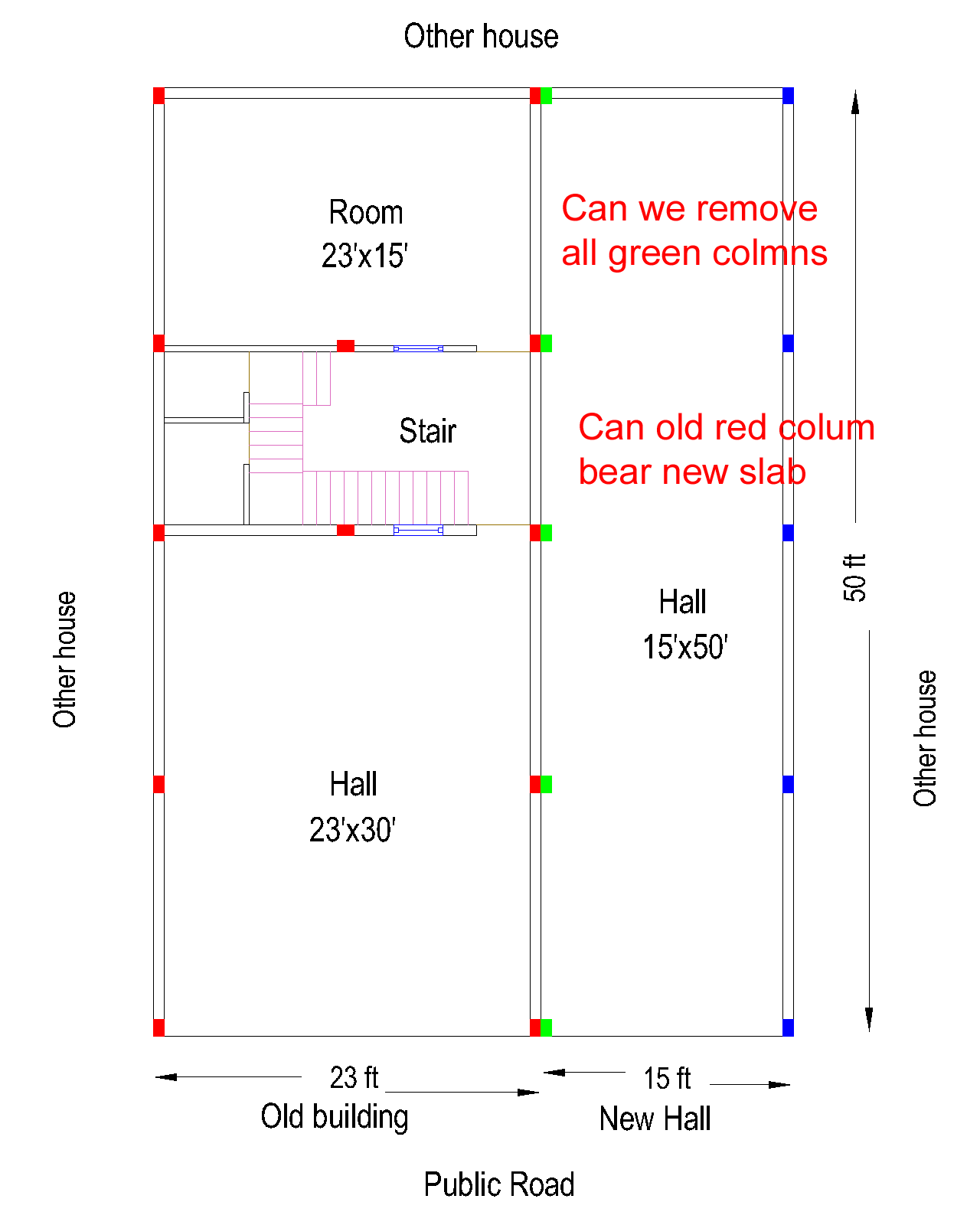

Hi all.
please see my plan and actual site photo which I have attached here. As you can see in photo I have a building in left side, which was made 5 years ago. It is made upon RCC pillers and beams.
Now I want to make a new hall in right hand side, which you can see open land  in photo. this hall will be 15 ft x 50 ft.
My question is, can I remove green color colms ( pls see Plan). can old colms bear the load of slab. How can new beam be rested on old colms. In future the whole building will be made upto first floor also.
Attachments: Photo.PNG on Tue Apr 22, 2014,
Plan.png on Tue Apr 22, 2014,&n
Wed Apr 23, 2014Post  #1
Dear Purvind see the condition
       The strength of the column can be known if there is structural design available for laid column. In the absence of design detail no one predict about that they will bear the load. In this situation have help from local structural engineer, who can inspect site and see the condition of concrete and also about steel reinforcement and foundation.If columns are capable of taking the load than the question arises for arrangement of beam on old column.

Mon Apr 28, 2014Post  #3
Dear Panchal
      What type of help or information do you need.
Mon Apr 28, 2014Post  #4
Post subject: Colum and Structure
Hello..! Purvi..Kindly follow the suggestion given by Resp.Gupta Sir.. ,or a separate structure can be designed for new construction work , the new columns can be merged in interior designs,if  openings are required....Regards

Hi  Purvi ,
Did you find any solution for this ? I had a same situation like this and i am going to avoid old column. Please post your findings.
Wed May 07, 2014Post  #6
DK
DK
Join date: Feb 2013
what is the size of your colms (OLD and new)?
