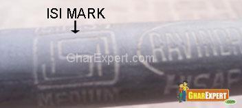

Purchasing C.I. Pipes
Cast iron pipe is generally used in sewer lines. The following points should be kept in view while purchasing CI pipes.
  • The pipe should bear ISI marks and must be heavy duty pipe.
  • The pipe must be free from pinholes, cracks and has a good finish.
  • The leakage should be checked by erecting the pipe temporarily in earth and filling it with water up to the top. If there is any hole or crack in the pipe, the water will come out. Hence the pipe should be rejected.
  • All CI pipes and fittings should give clear ringing sound when struck with light hand hummer.
  • All CI pipes and fittings are hot, dip coated inside and outside the tar/bitumen coating.
  • Heavy Duty PVC pipes are also equally good if used with proper jointing and care while designing. These pipes have 50% more life and are cheaper than C I pipes also.

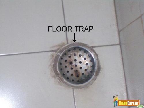

Precautions While Laying Sanitary and Sewer Pipes
  • Generally it is observed that the top of floor trap is not fixed by taking proper level of floor of the building; which creates problems of drainage.
  • Floor trap should be fixed after marking proposed floor level.
  • The top of floor trap in toilet and kitchen should be 12 MM to 20 MM down from floor level of the building to provide proper slope for easy drainage of water.

The pipes and fittings has to be of PN20 grade not PN16. Also make sure that you buy a good brand with ISI mark on it.
