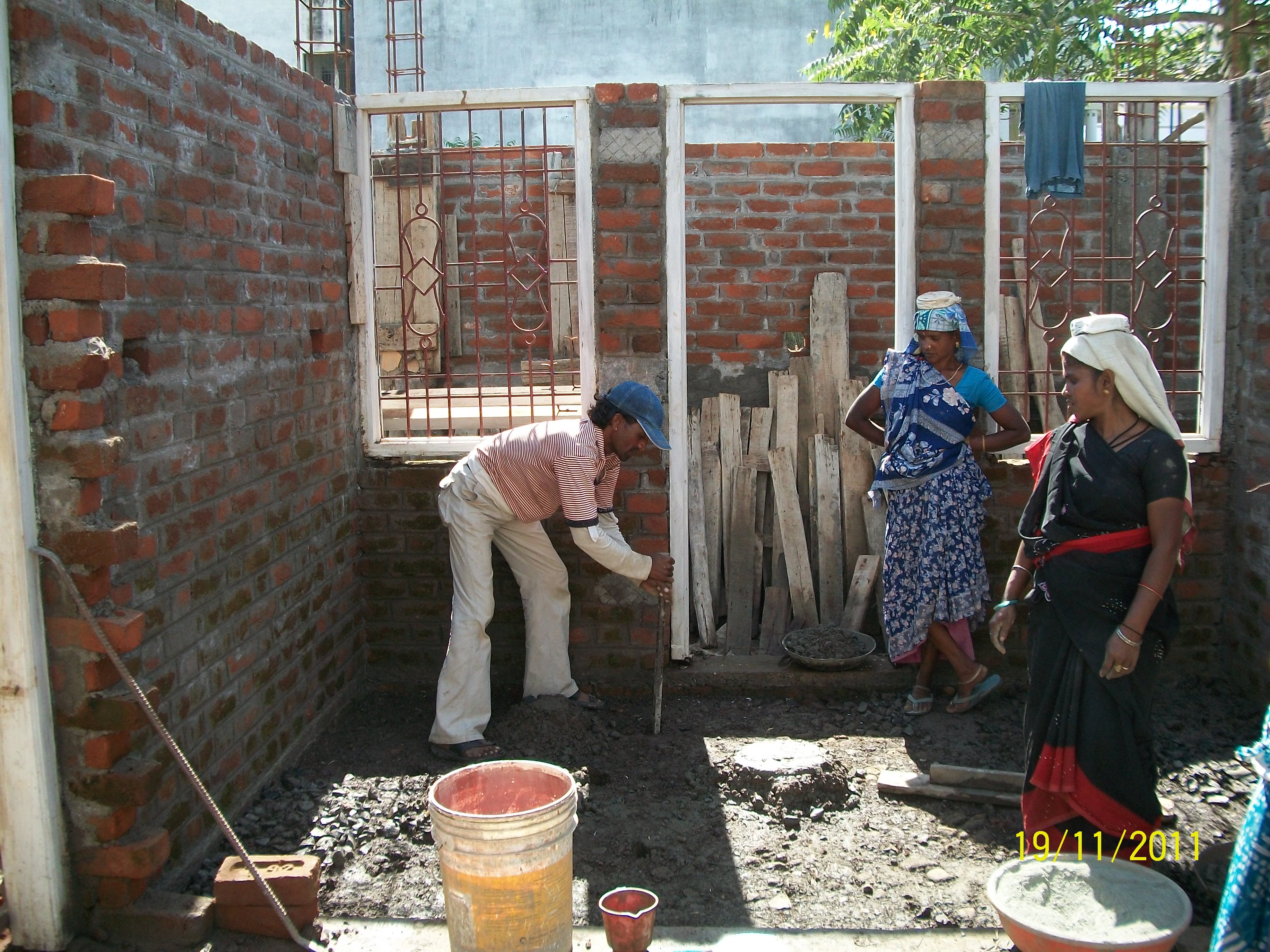

I am building a 4 storey building , After finishing the column foundation and column , contractor suggested and dig soil from inside of the foundation for plastering, leaving a certain distance from the column footing and it is more than depth of column basement , and that foundation is filled with Quarry waster(slurry , msand waste ), Now the qaurry waste is act like a rubber and day by day it is setting down when we fill water in the foundation .
Please reply any suggestions.

Hello...! Viju,  It is not clear that what was  the need of  putting wastes in the foundation? What was the plan in Contractor's mind.?...God knows.. If you are going for 4 stories building ..kindly contact and hire Building Experts...regards

Hi,Navneet, It is not such a waste image attached. availability of red soil is the reason to fill it with MSAND waste (powder type).

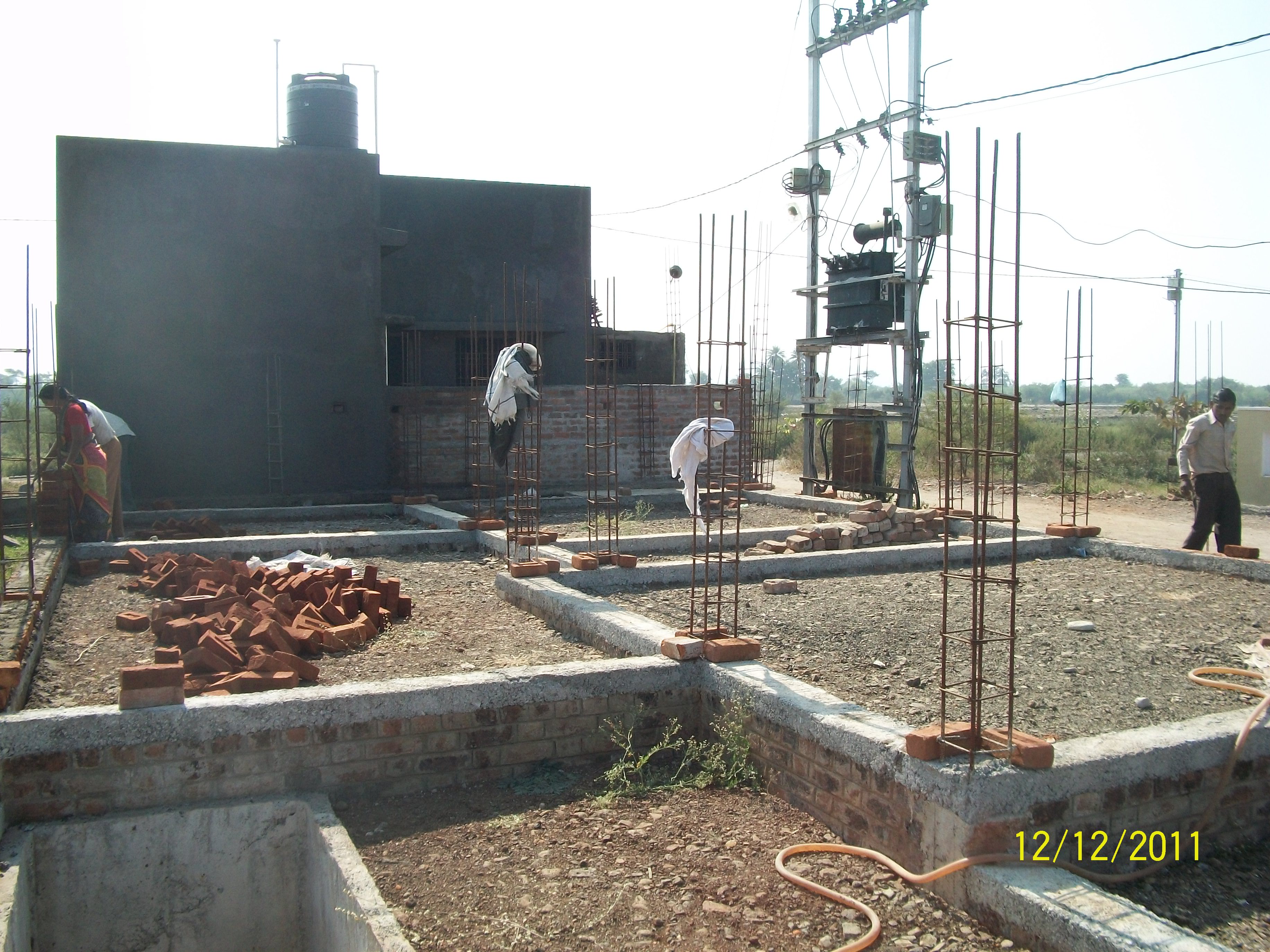

Dear Viju, hello..Do  you want to go for Basement or filling  the pit ? If it is for filling the pit, then solid materials like Hard Core Moorum (soil + boulders) should be used in layers of 1'3",and each layer watered and compacted by ramming properly ..up to 3" under plinth level.. after that Base Concrete(3") can be laid...hope it will solve your quarry .....Regards

We used that Slurry for filling the pit upto the foundation then from the foundation to floor level planning to fill one layer of gravel then above that concrete floor.
