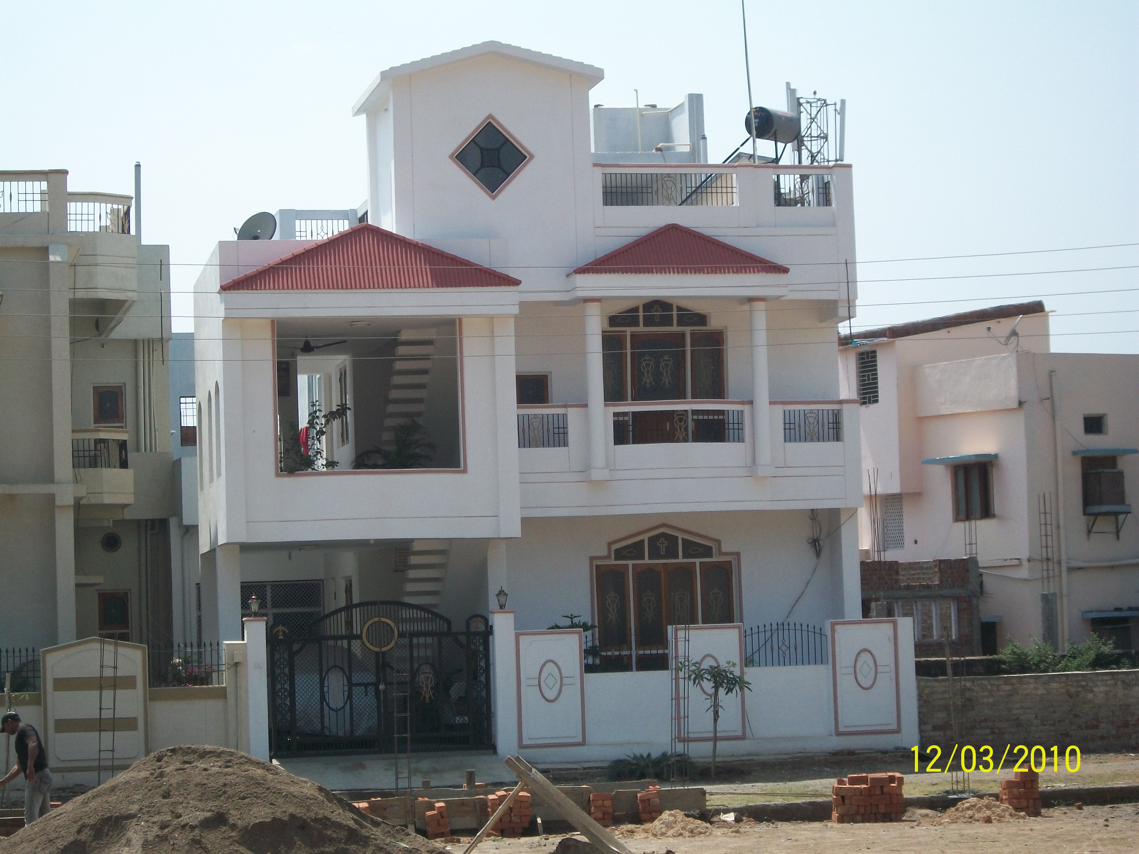

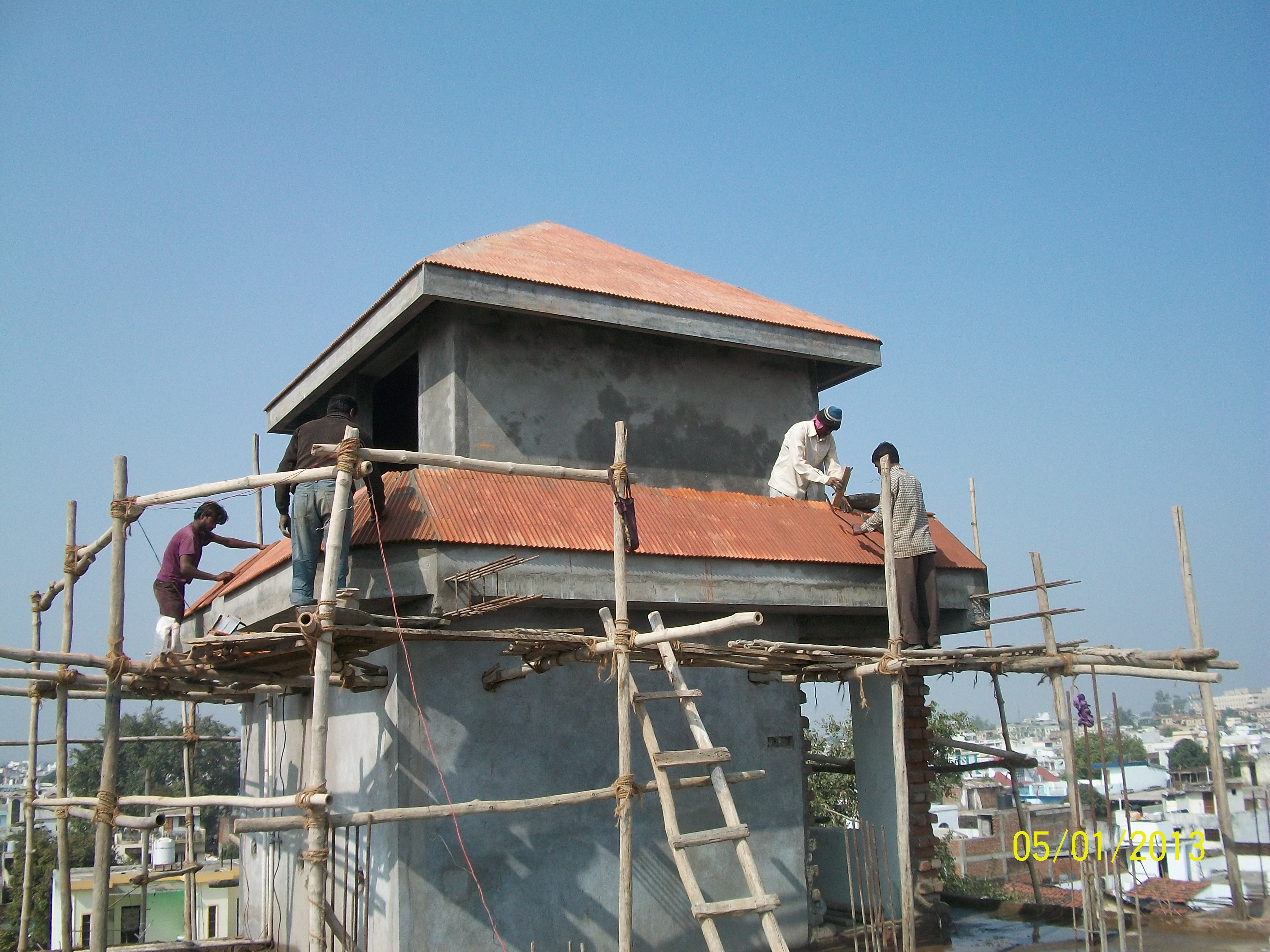

Sat Oct 26, 2013 | Post #5 | Navneet Jharia
Join date: Dec 2010 | Post subject: To Protect PVC Tank from Heat & Sunlight.
Hello...! Purvi..Brick work and decorative roof according to elevation Or Hidden AC Sheet roof can be used to protect PVC Tanks. Kindly go through attached files to clear views. regards | | | |
