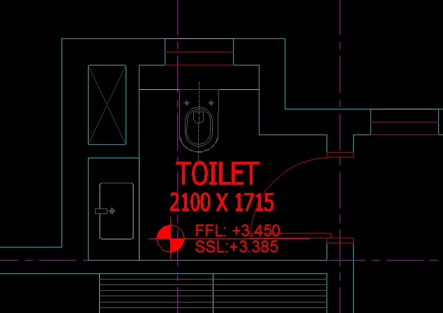

hi sir,
here is the toilet layout for a house im doing...is there a need for a sunken slab?i have provided a shaft already..its gong to be an english seat.culd you explain the usage and need of both shafts and sunken slab together?

The sunken slab is may be required for the drain purpose, the shafts are for light and ventilation.
Mon Apr 13, 2015
Dear Amog
The Sunken slab is required if you want to fix Indian Type pan of w c sheet. If you are fixing English sheet than sunken toilet slab is not required.

If you want to maintain same finished floor level in toilet and rooms, sunken slab is required

FOR ENGLISH SEAT, IT REQUIRE 6 INCH SUNK AND FOR INDIAN TYPE IT REQUIRE 6 INCH SUNK.

Write in detail what type of information do you want.
For Indian type toilet seat the slab should be at least 18'' sunk.
