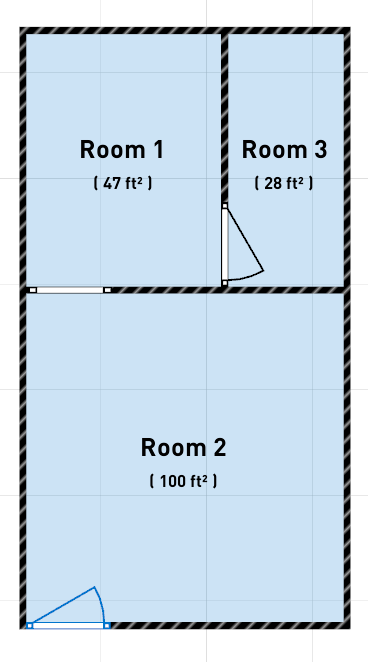

I want construct rcc and slab for 10x18 area (1RK) - Foundation, ground floor, first floor, second floor, stairs.
Kindly help me on below queries.
1. What is a total area for Grndflr+1stflr+2ndflrXlabour rate?
2. How much material I will need for above area for rcc and slab work.
khadi
reti
dust
cement
steel
please find the attached basic plan.
Thank you for ur help.
rcc work.PNG on Tue Oct 27, 2015,&n
Tue Oct 27, 2015
As per the plan:
The total area is 100+47+28 x number of floors.
The material you need is approximately for each floor:
Around 400-500 kg steel
15-20 Cement bags
50-60 ft. Dust
50-60 ft. Rodi
150-200 ft. of Reti for 3 floors plaster is enough.
