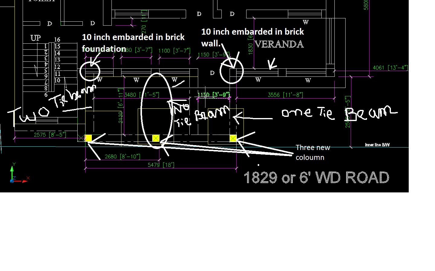

thnks sir for previous reply.
now i have one quires?
i making a new extension with rcc column foundation attached with previous brick foundation house.
i have make three new column with rcc and tie beam push in brick foundation up 10".but 2 tie beam push in brick wall but one tie beam not there?is it effect the house if is no tie beam there?
pls see my photo if i clearly not explain,
thanks sir

Dear AD
There is no need of tie beam in such a small building. If you laid two nos it is OK
