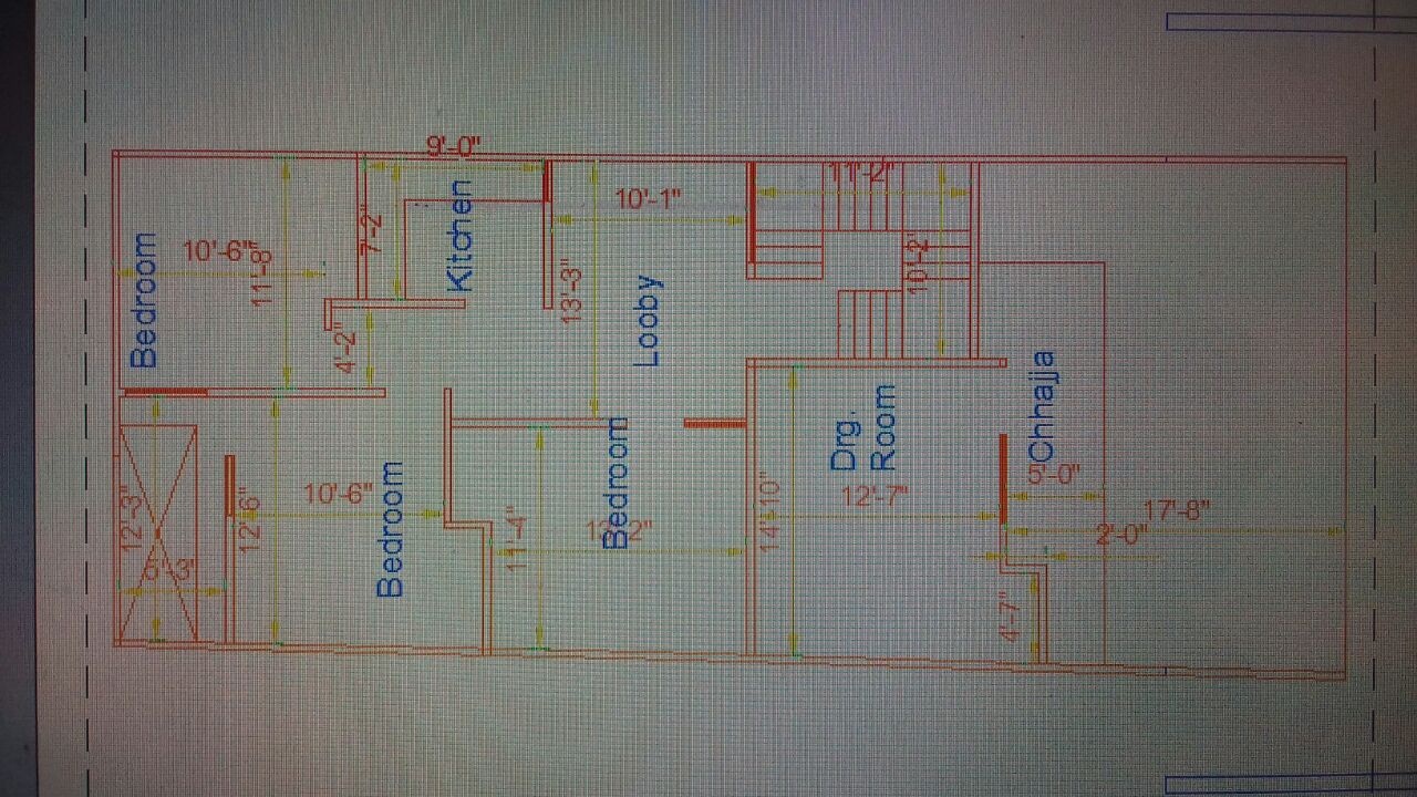

Post subject: Cost Comparison of RCC & RBC Slab system for 130...
????? 1300 ???? ??? ??????? ??? ?? ??? ??? ??? ?? ???? ?? ?????  ?????? ???  ?? ?? ????? ??? ????? ?????? ?? ?????? , ?? ????? ??? ??? ???? ?????? ???? ?? ?????  ????? ?????
Attachments: IMG-20180326-WA0017.jpg Thu Apr 19, 2018,&n
